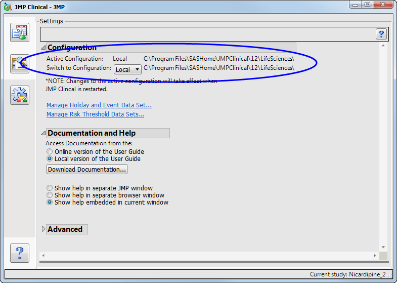

How can I change the location of and share my studies with other users?
To set up a shared location for your studies, you must first map a location on a shared drive and then modify the installation.configuration.preferences file that is installed with JMP Clinical.

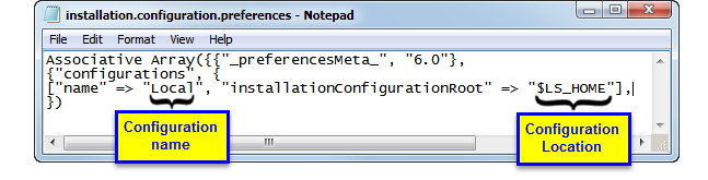

Examine the installation.configuration.file shown below:
The key statement in this file is:
[“name” => “Local”, “installationconfigurationroot” => “$LS_HOME”]
This line defines both the name and location of the default configuration. In this case, the name of the configuration is Local and it is located in the $LS_HOME, which in the default installation is set to C:\Program Files\SASHome\JMPClinical\12\LifeSciences\. This is the location shown on the JMP Clinical Settings tab, as shown below:
To add a new or existing shared location, you must copy and modify this key statement so that in defines both the name and the location of the new shared location.
| 8 | Use OS commands to map the drive where the new share is to reside. In this example, the shared drive is defined as drive S:. |

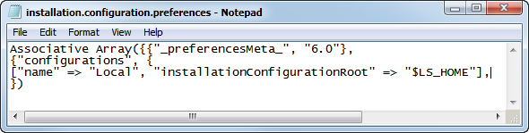

| 8 | Navigate to the JMP Clinical installation folder (normally C:\Program Files\SASHome\JMPClinical\12\LifeSciences) on your local machine and open the installation.configuration.preferences file with a text editor. |
| 8 | Copy the key statement, including the square brackets. Enter a comma (“,“) directly after the key statement and then paste the copy directly after the comma. It should appear as shown below: |
[“name” => “Local”, “installationconfigurationroot” => “$LS_HOME”],[“name” => “Local”, “installationconfigurationroot” => “$LS_HOME”]

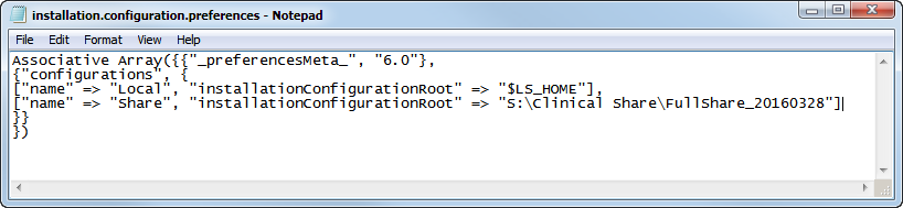

| 8 | Change the name and location in the pasted copy to the name and location of the share. In this case the name is Share and the location is S:\Clinical Share\FullShare_20160328. Your name and location must be enclosed by the quotation marks. The modified statement should appear as shown below: |
[“name” => “Share”, “installationconfigurationroot” => “S:\Clinical Share\FullShare_20160328”]
Note: Entries are case-sensitive.
Caution: In the example shown here, the location is specified using a mapped drive path. Locations should contain mapped drive paths only if your organization's setup guarantees that all users have the same mapped drives. If you are unsure, you should use the UNC path instead.
The modified file is shown below:
| 8 | Save and close the file. |
You must exit out and reopen JMP Clinical before the changes take effect.
| 8 | Close and then reopen JMP Clinical. |

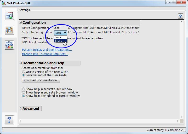

| 8 | Click the Settings tab and then on the Configuration drop-down menu. |
The new “Share” configuration is now shown as an option.
| 8 | Select Share. |
You must close and reopen JMP Clinical before the new selection takes effect. If the new Share folder is an existing shared folder, studies contained within the folder are displayed on the Studies tab. If this is a new shared folder, JMP Clinical adds the necessary components for the folder to function as a shared studies folder.
Note: Anyone with Read/Write privileges on the shared drive has access to a new shared folder. As the creator of this folder you can control level of access by changing the permissions using WinO/S commands.

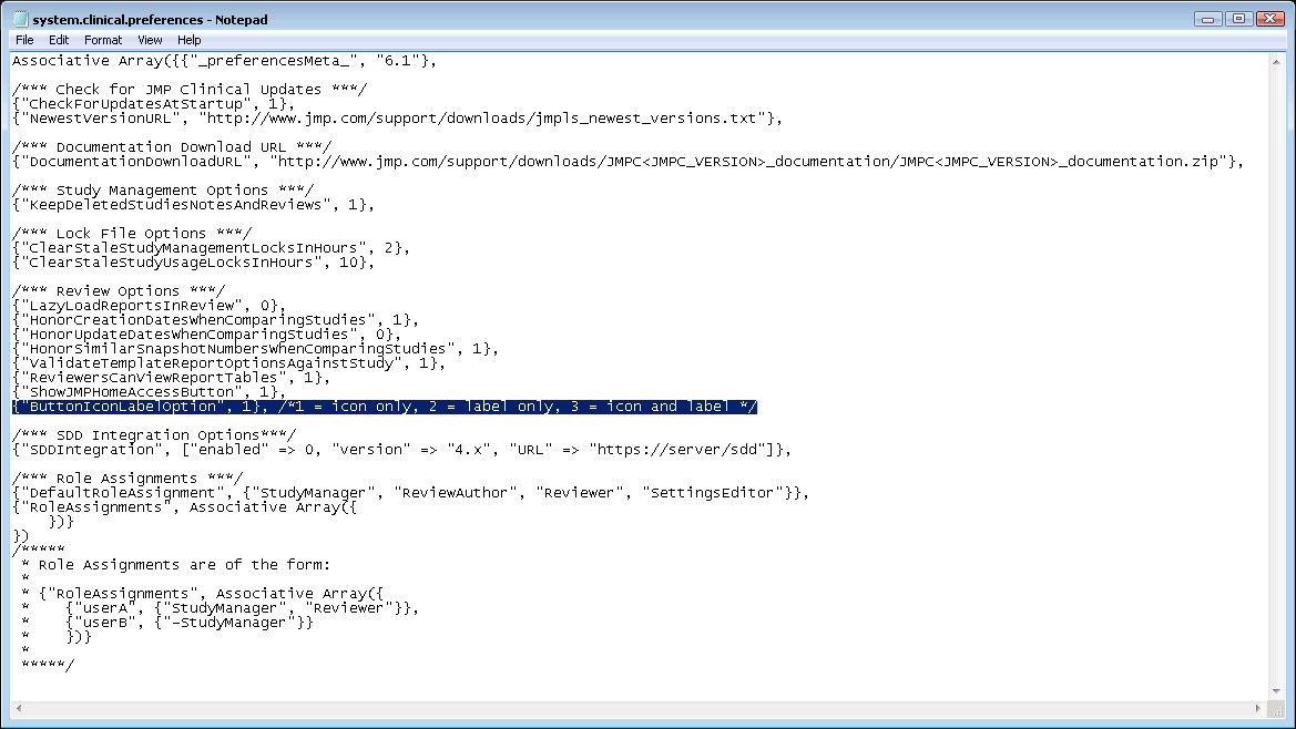

How do I view Action Button labels in addition to icons?
By default, JMP Clinical represent action buttons using icons. You can view the button label by positioning your pointer over the icon. You can change this display if you would prefer to display the label in place of or in addition to the icon. To make this change, you must modify the system.clinical.preferences file (the default local location for this file is the C:\Program Files\SASHome\JMPClinical\12\LifeSciences directory).
| 8 | Open the system.clinical.preferences file with a text editor. |
The file shown below opens. The text to be modified is highlighted.
By default, the ButtonLabelOption is set to “1” to display icons only, as shown below:
| 8 | To view button labels in place of icons, change the text {“ButtonLabelOption”, 1} to {“ButtonLabelOption”, 2}. The buttons appear as shown below: |
| 8 | To view button labels and icons, change the text {“ButtonLabelOption”, 1} to {“ButtonLabelOption”, 3}. The buttons appear as shown below: |
Note: You must include the quotation marks as shown in the text above. Entries are case-sensitive.
| 8 | Save and close the system.clinical.prefereneces file. |
| 8 | You must exit and reopen JMP Clinical in order for these changes to be registered. |

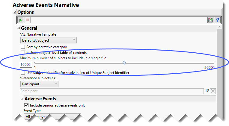

How do I change the page threshold for splitting narratives?
The Adverse Events Narrative report generates an rtf copy of the narrative. These narratives can be quite extensive and so run up against Microsoft Words page limit of 32,000 pages. Because of this, we have set JMP Clinical to split the narratives, by subject, into multiple documents when a threshold of 10,00 pages is reached. The document is split every time the threshold is reached. For example, a narrative of 32.000 pages is split first at 10,000, a second time at 20,000, and a third time at 30,000 resulting in 4 documents.
This feature is hidden but you can change the threshold by the following steps:
| 1 | Navigate into the JMP Clinical ProcessLibrary folder (default location: C:\Program Files\SASHome\JMPClinical\15\Clinical\ProcessLibrary) and open the AENarrative.xml file using a text editor. |
| 2 | Scan down to line 30 to see the following code: |
<input name="EVTSPRFL" type="slider" label="Maximum number of subjects to include in a single file" required="false" value="10000" hidden="true">
| 3 | Change the word "true" (highlighted in the line above) to "false" and save the file. |
| 4 | Close and reopen JMP Clinical. |
| 5 | When you open the AE Narrative report, you will see a new option in the General section, circled in the figure below: |
| 6 | Either enter the desired value in the text box or use the slider to set the desired value. |
JMP Clinical will use this new threshold to determine where to split the narrative document.

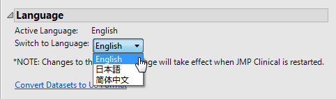

How do I view JMP Clinical in a language other than English?
JMP Clinical supports use of either both English and Chinese languages, as well as partially supporting Japanese.
| 8 | Use the Switch to Language drop-down menu to change language usage by JMP Clinical. |
| 8 | You must exit and relaunch JMP Clinical in order for the language change to take effect. |
If you do not see all three languages in the drop-down menu, you probably need to rerun the original JMP Clinical installer to add them to your JMP Clinical installation.

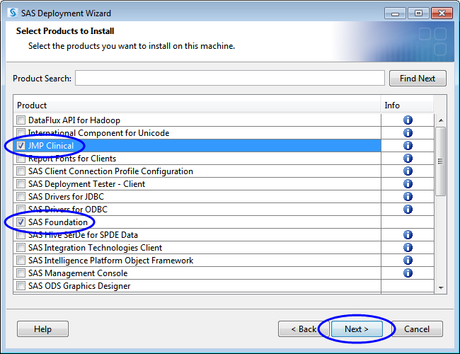

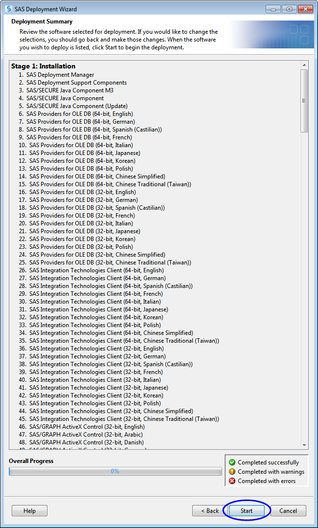

Adding Additional Language Support for JMP Clinical
| 8 | Exit and close JMP Clinical. |

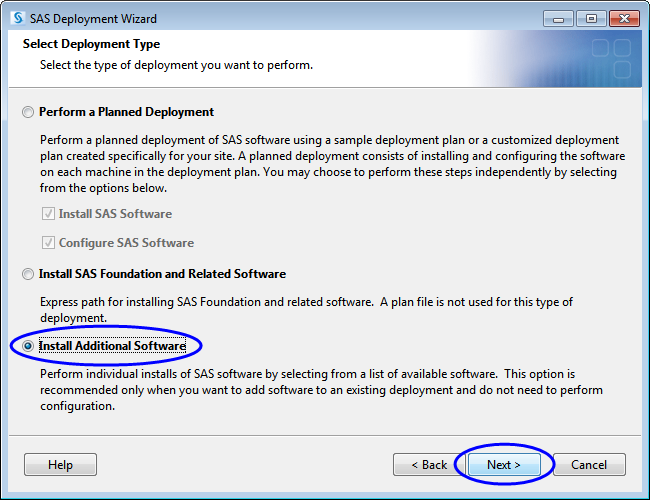

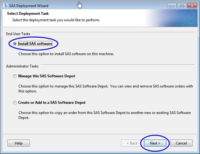

| 8 | Navigate to your SAS Software Depot (typically found at C:\SAS Software Depot) and double-click to open the SAS Deployment Wizard. |
| 8 | Select Install SAS Software and click . |
| 8 | Select Install Additional Software and click |
| 8 | Select both JMP Clinical and SAS Foundation and click . |
| 8 | Click on the next few windows. |

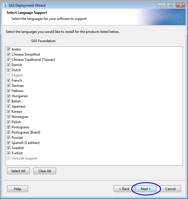

| 8 | Make sure all of the languages are checked on the Select Language Support , as shown below. |
| 8 | Click . |
| 8 | Review the Deployment Summary (shown below) and click . |
| 8 | When all components have been successfully installed, click and/or in this and all subsequent s to complete and exit the installer. |
| 8 | Reopen JMP Clinical. Options for selecting English, Japanese, and Chinese should now be available in the Switch to Language drop-down menu. |
