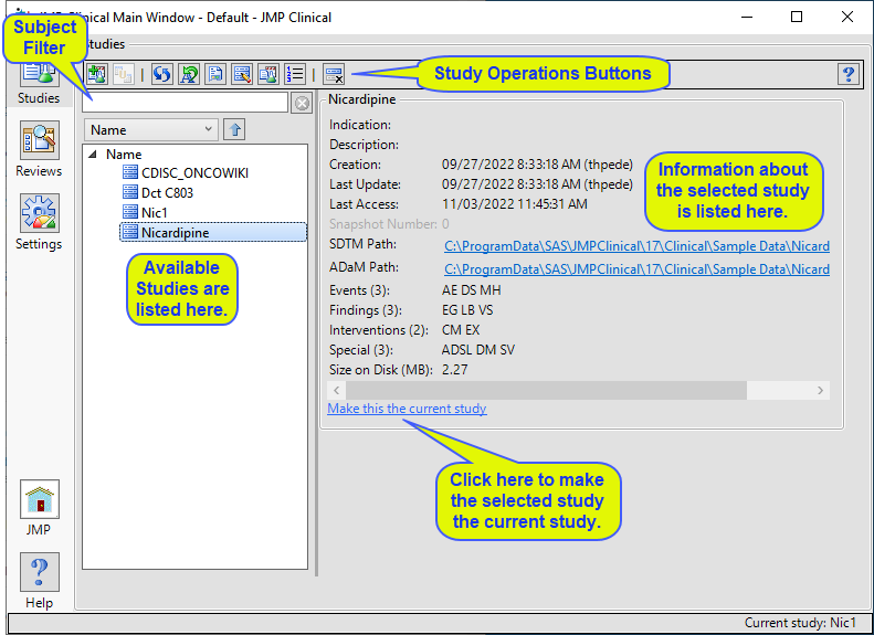

All study additions and manipulations are done on the Studies tab shown below:
Note: For instructions on how to add the Nicardipine example study that ships with JMP Clinical, see Add Study...
Available Studies
All of the registered studies available to you are listed here. Studies can be sorted by various criteria in ascending or descending order.
| 8 | Click to select a study. Use -click to select multiple studies. |
Study Information
Information about the selected study is shown in the panel on the right side of the window. This includes the date the study was created, when it last updated and when it was last accessed. Additionally, the location of the study data within your file structure is shown along with a list of the domains that make up your study data. In the Nicardipine study shown above, there are 3 events domains (AE, DS, and MH), 3 findings domains (EG, LB, and VS) 2 interventions domains (CM and EX), and three special domains (ADSL, DM, and SV).

Study Operations
Use these buttons to add, manipulate, or delete registered studies.
Add Study: Click
to use Add Study...
Combine Studies: Click
to combine two studies using Combine Studies . Note: This option remains unavailable unless two studies are selected.
Refresh Study Metadata: Click
to update the metadata file for the selected study.
Rename a Study: Click
to rename a study.
Snapshot History: Click
to use Snapshot History to generate a summary report of the snapshot history for the currently selected study
Update Study with New Snapshot: Click
to update the selected study with a new snapshot. See Update Study with New Snapshot for more information. Note: This option is available only if the Enable Future Snapshot Comparisons option was checked when you added the Study.
Set Study Preferences: Click
to globally set custom study-level attributes, subject-level preferences, analysis preferences for each CDISC class of reports, preferences for calculating study days, as well as preferences for advanced operations. See Set Study Preferences for more information.
Set Value Ordering in Studies: Click
to use Set Value Order and Color in Studies to specify the order and color of values within variable specific plots, such as histograms, and tables, as well as the order of value-comparison plots and tables within output.
Delete Studies: Click
to delete the selected study. After a study is deleted, its notes and reviews folders remain where they were. The log and result files are moved to \ProcessResults\ directory and the study folder under studies is deleted. Note: If the KeepDeletedStudiesNotesAndReviews system preference is activated on Manage Configurations (this preference is Off by default), all notes and reviews are deleted as well.
