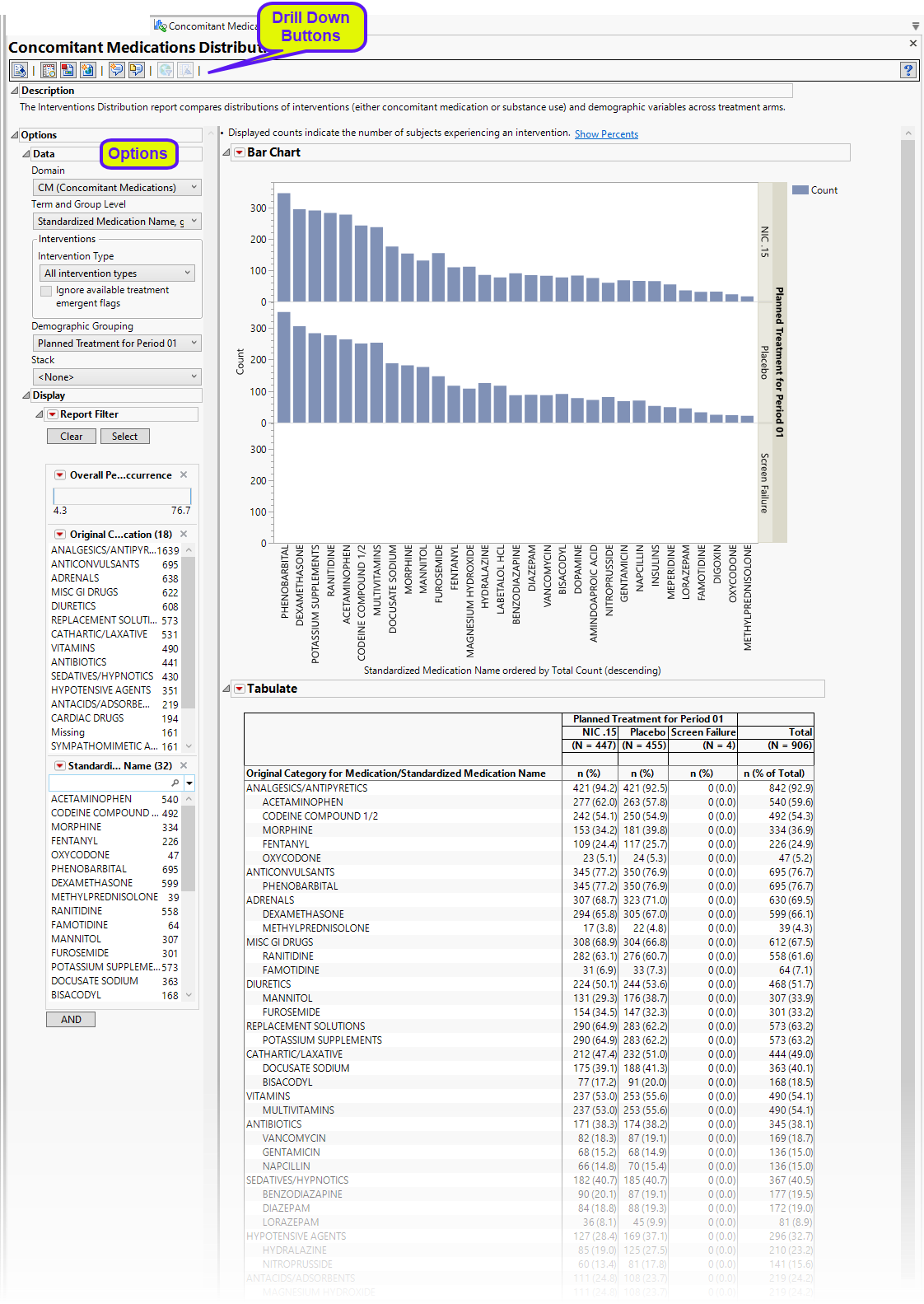

Interventions Distribution
This report compares distributions of interventions (either concomitant medication or substance use) and demographic variables across treatment arms. It reports each subject only once per intervention regardless of how many incidents of the intervention occur.
Note: Refer to Distribution Reports for a description of the general analysis performed by the JMP Clinical distribution reports.
Report Results Description
Running this report for Nicardipine using default settings generates the report shown below.
The report contains the following elements:

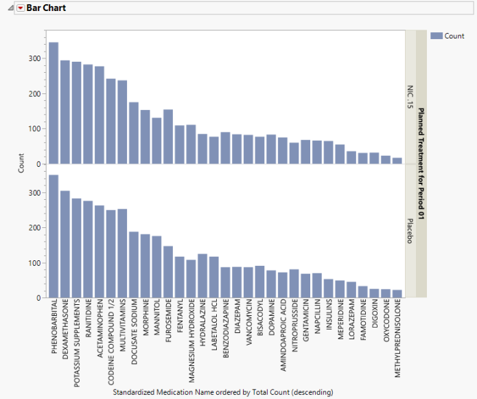

Bar Chart
Using a Bar Chart or Tree Map, this section summarizes the counts (or percentage of subjects) receiving the specified type of intervention during the course of the study. Results can be displayed either as total counts or percentages.
In the example shown here, counts of concomitant medications administered by treatment are displayed.

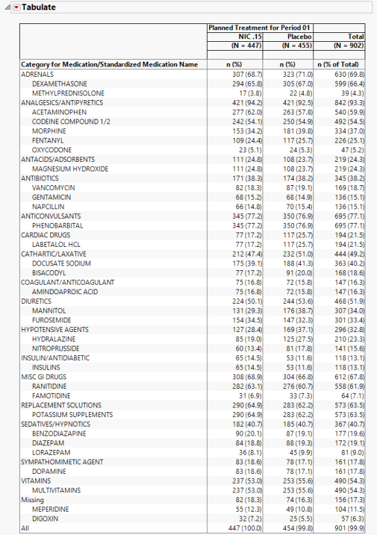

Tabulate
The Tabulate section contains one Table detailing the counts (and Percentages) for each treatment group, for each intervention within each specified term and group level. The counts, represented by n, are the number of subjects who experienced the given intervention. The All row at the bottom of the table is the number of subjects who experienced at least one intervention.
The Tabulate section contains one Table detailing the counts (and Percentages) for each treatment group, for each dictionary-derived term within each body system or organ class.

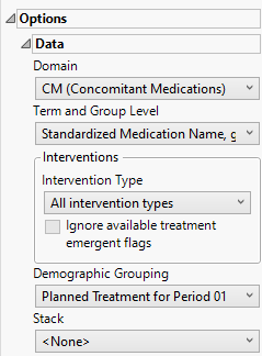

Options
Data
Use the drop-downs on this panel to customize your analysis.
Domain
Use this widget to select the intervention domain (either Concomitant Medications or Exposure , for example)to analyze.
Term and Group Level
Term and Group Levels are determined by the coding dictionary for the Event or Intervention domain of interest, typically these levels follow the MedDRA dictionary. Use this widget to indicate how each intervention is named and the level at which the interventionis considered. The term level will determine which term is displayed on the x-axis of the bar chart. Both the term and group level will be shown in the table with term level nested within group level.
Intervention Type
Analysis can consider all interventions or only those that occur at specific times before, during, or after the trial period. For example, selecting On treatment events as the Intervention Type includes only those interventions that occur on or after the first dose of study drug and at or before the last dose of drug (+ the offset for end of dosing).
Ignore available treatment emergent flags
If you choose to Ignore available treatment emergent flags, the analysis includes all interventions made on or after day 1 of the study when the intervention type is Treatment emergent interventions.
Demographic Grouping and Stacked
Results can be viewed as a whole or they can either be split out by Demographic Grouping or Stacked to show different levels within each event. Demographic Grouping will change the variable displayed on the y-axis of the bar chart, as well as change the variable used across the top of the table to split the columns. Stack only impacts the bar chart by stacking the bars according to the levels of the chosen variable. For example, if severity is chosen, the bars will be stacked by mild, moderate, and severe events.
