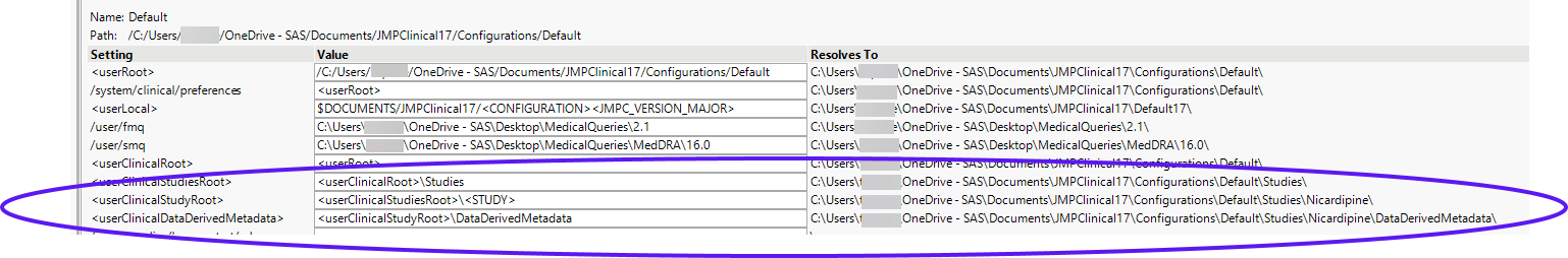

How does JMP Clinical know where to find my studies?
The location of your studies depends on the configuration you have selected on the Settings tab of the JMP Clinical main window. To find the location of the studies, click Manage Configurations on the Settings tab to open the Manage Configuration window. The location of the study data is listed in the advanced path options, as shown below:

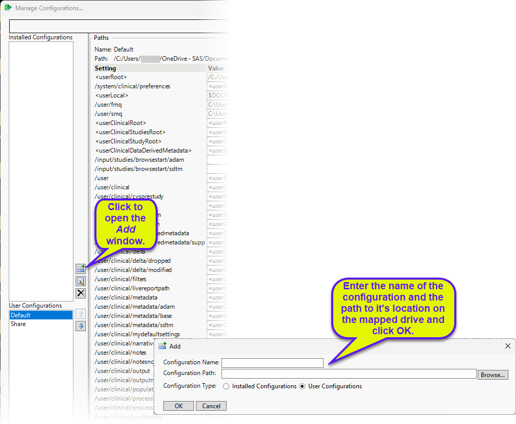

How can I change the location of and share my studies with other users?
To set up a shared location for your studies, you must first map a location on a shared drive and then add a Shared configuration to the Manage Configuration file that is installed with JMP Clinical.
| 8 | Examine the installation.configuration.file shown below. |
| 8 | Save and close the file. |
You must exit out and reopen JMP Clinical before the changes take effect.

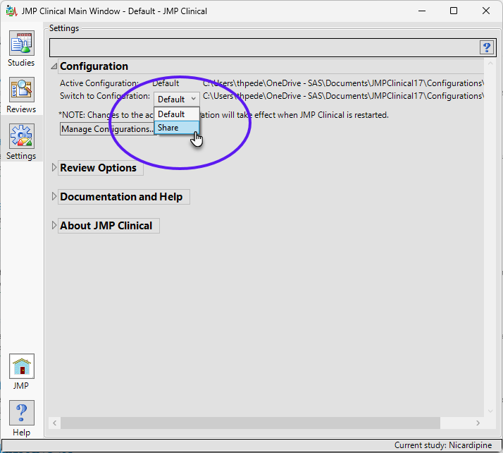

| 8 | Close and then reopen JMP Clinical. |
| 8 | Click the Settings tab and then on the Configuration drop-down menu. |
The new “Share” configuration is now shown as an option.
| 8 | Select Share. |
You must close and reopen JMP Clinical before the new selection takes effect. If the new Share folder is an existing shared folder, studies contained within the folder are displayed on the Studies tab. If this is a new shared folder, JMP Clinical adds the necessary components for the folder to function as a shared studies folder.

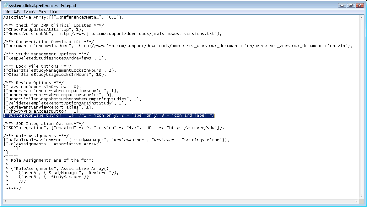

By default, JMP Clinical represent action buttons using icons. You can view the button label by positioning your pointer over the icon. You can change this display if you would prefer to display the label in place of or in addition to the icon. To make this change, you must modify the system.clinical.preferences file (the default local location for this file is the C:\Program Files\SASHome\JMPClinical\12\LifeSciences directory).
| 8 | Open the system.clinical.preferences file with a text editor. |
The file shown below opens. The text to be modified is highlighted.
By default, the ButtonLabelOption is set to “1” to display icons only, as shown below:
| 8 | To view button labels in place of icons, change the text {“ButtonLabelOption”, 1} to {“ButtonLabelOption”, 2}. The buttons appear as shown below: |
| 8 | To view button labels and icons, change the text {“ButtonLabelOption”, 1} to {“ButtonLabelOption”, 3}. The buttons appear as shown below: |
Note: You must include the quotation marks as shown in the text above. Entries are case-sensitive.
| 8 | Save and close the system.clinical.prefereneces file. |
| 8 | You must exit and reopen JMP Clinical in order for these changes to be registered. |
