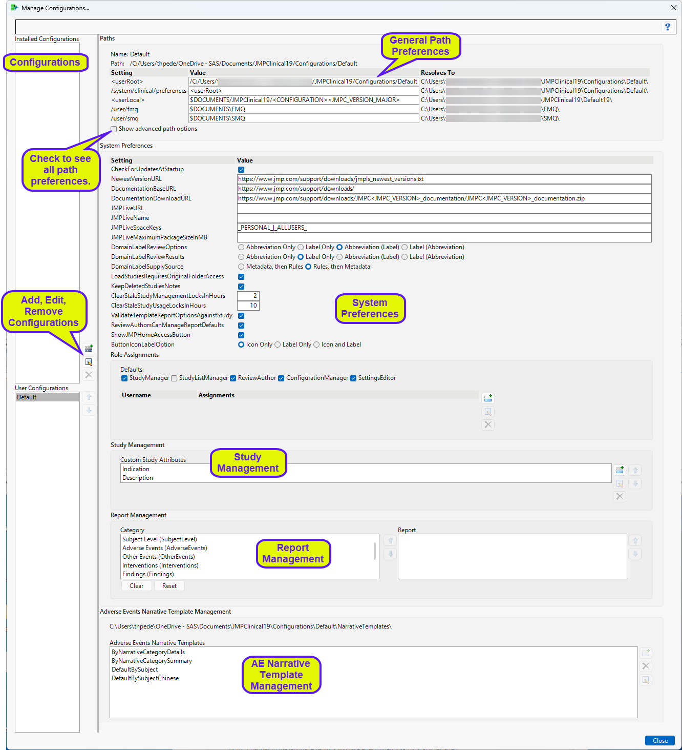

Manage Configurations
The Manage Configurations... window is accessed from the Settings tab of the JMP Clinical Main Window.
8 Click to open the Manage Configurations... window, shown below:

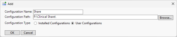

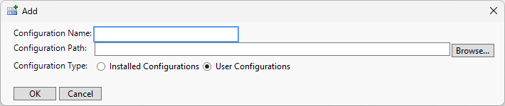

8 Click to open the Add window shown below:
8 Specify a name for your configuration.
In this case, the configuration is named Share.
8 Click to open a Choose Directory window.
8 Navigate into the Clinical Share folder and click .
8 Click the User Configurations radio button.
The Add window appears as shown below:
8 Click .

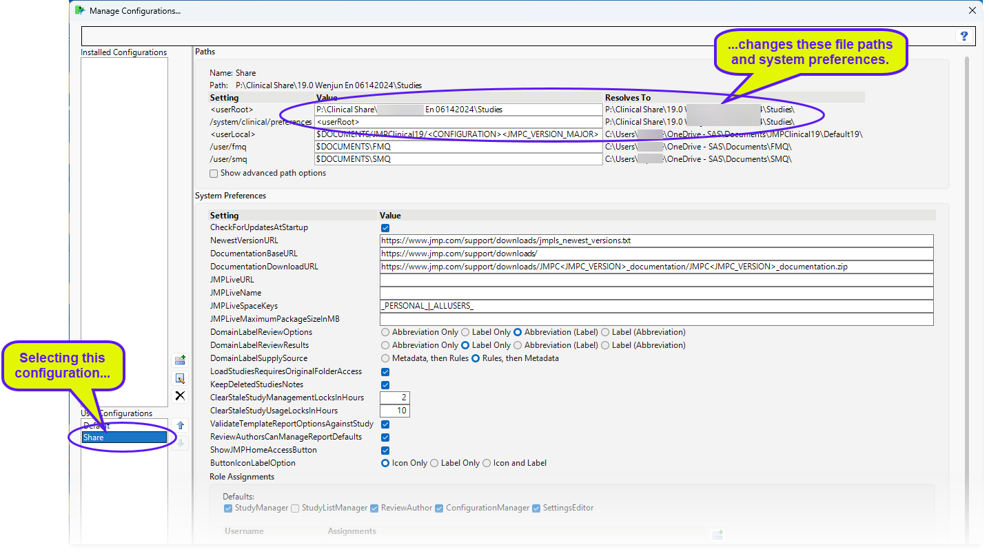

The new configuration is added to the Manage Configurations window. If you select it, all of the default paths and system preferences are displayed, as shown below:
Note: While all paths and preferences are editable, you should consult your system administrator before making any changes.

System Preferences
System preferences enable you to set preferred behaviors for JMP Clinical. Options include automatic checking for updates specifying how domains and buttons are identified on the user interface, which dates and snapshots to honor when comparing studies, and so on. Use the available controls to customize your installation of JMP Clinical.
See the tables below for descriptions of each option:
JMP Clinical Updates
Key
Description
Settings
CheckForUpdatesAtStartup
Specifies whether automatic update checks occur.
• Checked - Automatically check at start-up. If updates are found, a notification is shown on the Settings > About JMP Clinical pane.
• Unchecked - Disable automatic checks at start-up. You can manually check for updates using Settings > About JMP Clinical > button.
NewestVersionURL
Specifies the URL used to determine whether updates are available.
http://www.jmp.com/support/downloads/jmpls_newest_versions.txt
Documentation
Key
Description
URL
DocumentationBaseURL
Specifies the URL containing the online JMP Clinical documentation
DocumentationDownloadURL
Specifies the URL from which to download documentation.
http://www.jmp.com/support/downloads/JMPC<version>_documentation/JMPC<version>_documentation.zip
JMP Live
Key
Description
URL
JMPLiveURL
URL to the JMP Live instance you are publishing to.
To be determined by your system administrator.
JMPLiveName
Name of the JMP Live instance
Not applicable
JMPLiveSpaceKeys
Keys of the JMP Live Spaces available to the current user.
Not applicable
JMPLiveMaximumPackageSizeInMB
The maximum size of a JMP Live package. Set by your system administrator
Not applicable.
Labeling
Key
Description
Option
DomainLabelReviewOptions
Specifies how domains are identified on the report options.
Abbreviation Only: Defines a domain on the report dialog and all options by its abbreviation only. For example, the Laboratory Test Results domain is defined as LB.
Label Only: Defines a domain on the report options by its label. The label displayed is the version specified using the DomainLabelSupplySource option. only. For example, the LB domain is defined as Laboratory Test Results.
Abbreviation (Label): Defines a domain on the report options by both its label and its abbreviation. For example, the Laboratory Test Results domain is defined as Laboratory Test Results (LB).
Label (Abbreviation): Defines a domain on the report options by both its abbreviation and its label. For example, the Laboratory Test Results domain is defined as LB (Laboratory Test Results)
DomainLabelReviewResults
Specifies how domains are identified on the report results, graphics, and tables.
Abbreviation Only: Defines a domain on the report results by its abbreviation only. For example, the Laboratory Test Results domain is defined as LB.
Label Only: Defines a domain on the report results by its label only. For example, the LB domain is defined as Laboratory Test Results.
Abbreviation (Label): Defines a domain on the report results by both its label and its abbreviation. For example, the Laboratory Test Results domain is defined as Laboratory Test Results (LB).
Label (Abbreviation): Defines a domain on the report results by both its abbreviation and its label. For example, the Laboratory Test Results domain is defined as LB (Laboratory Test Results)
Specifies which label to preferentially display in report options and results: the one found in the study metadata or the one specified by CDISC rules.
Metadata, then rules: When this option is selected, JMP Clinical first attempts to find and use labels in the study metadata file. It then assigns a label, based on CDISC rules, for any domain missing a label in metadata.
Rules, then metadata: When this option is selected, JMP Clinical assigns labels based on CDISC rules. For custom domains, for which CDISC rules are not available, JMP Clinical uses labels found in metadata
Study Management Options
Key
Description
Options
LoadStudiesRequiresOriginalFolderAccess
Verifies that the user has permitted access to the original study data.
Note: JMP Clinical does nothing to subvert permissions.
Checked - When JMP Clinical is launched and studies are reloaded, the user will not see those studies for which the original study data has either been deleted or have had read access permissions revoked.
Unchecked - Users will see all studies previously added so long as the metadata is available.
LazyLoadStudies
Specifies when to load the metadata for one or more studies.
Checked - Loads metadata when an operation is performed on a selected study.
Unchecked - Loads the metadata for all studies when you launch JMP Clinical
KeepDeletedStudiesNotes
Specifies whether to retain the notes associated with studies that you delete.
• Checked - When a study is deleted, do not delete notes associated with it. Choose this option to preserve study artifacts when you do not anticipate using the same study name in the future.
• Unchecked - When a study is deleted, delete notes associated with it.
Lock File Options
Key
Description
Supported values
ClearStaleStudyManagementLocksInHours
Specifies the amount of time, in hours, to wait before offering users the option to clear a study management lock.
A study management lock is a temporary restriction imposed on users to prevent conflict with an ongoing study management operation (for example, adding, combining, refreshing, renaming, and deleting studies). Under normal circumstances, these locks are removed automatically when the study management operation is complete. Operations on very large studies generally take more time. Exceptional system events might prevent the operation from completing, keeping the lock in effect.
Lower the value of this option to give users greater freedom to forcibly remove an outstanding study management lock set by another user.
0...1e+308, with fractional hours permissible.
ClearStaleStudyUsageLocksInHours
Specifies the amount of time, in hours, to wait before offering users the option to clear a study usage lock.
A study usage lock is a temporary restriction imposed on users to prevent conflict with an ongoing study usage operation (for example,, running reports in Review Builder). Under normal circumstances, these locks are removed automatically when the study usage operation is complete. A user leaving Review Builder open, as well as exceptional system events, might keep the lock in effect.
Lower the value of this option to give users greater freedom to forcibly remove an outstanding study usage lock set by another user.
Review Options
Key
Description
Options
ValidateTemplateReportOptionsAgainstStudy
Specifies whether to show a warning if the options specified in a review template are not available for the current study.
• Checked - Show a detailed warning notification if the review template specifies options that are not available for the current study. Offending and replacement values are shown, and offending values are replaced as needed.
• Unchecked - Do not show a warning notification if the review template specifies options that are not available for the current study. Offending values are replaced as needed.
ReviewAuthorsCanMangeReportDefaults
Enables the Review Author to save what the defaults are for each Report.
• Checked - Adds the icon to the options bar for each report. Checked by default. Options include:
• Save current options as defaults: Report uses and saves the options that are currently set and reuse those options whenever that report is added to the Review.
• Reload saved options defaults: Loads the currently saved options. This is useful if an author has added the Report to the Review, made changes to the options, and then wants to return to whatever was previously saved.
• Clear and reset factory defaults: Deletes the saved options for the current Report and reloads the factory defaults.
• Unchecked - Options listed above are not available
ShowJMPHomeAccessButton
Specifies whether to make the JMP button available on the JMP Clinical Main . This button surfaces the JMP Home , which allows easy access to core, non-Clinical specific, JMP functionality.
• Checked - The JMP access button appears on the JMP Clinical Main .
• Unchecked - The JMP access button does not appear on the JMP Clinical Main Window.
ButtonIconLabelOption
Specifies how to label reports in Review Builder.
• Icon Only: Label report tabs with an icon only. This is the most compact labeling option.
• Label Only- Label report tabs with a text label only. This takes up more horizontal space than an icon.
• Icon and label - Label report tabs with both an icon and a text label. This is the least compact labeling option.
