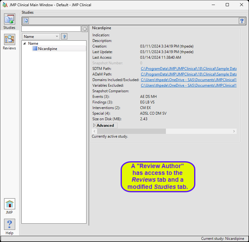

Review Author
A user with this role can create/edit/save Review Templates, do ad hoc analyses, and create and save Reviews. They can also manage the Holiday and JMP Life Sciences / SAS Institute Event data set and Risk Threshold data sets used by the configuration. A Review Author implicitly has the Reviewer role as well.
The “Review Author” main window is shown below:
The review author has access to a modified Studies window where they can select a study, view its snapshot history, and explore the subjects in the study. Review authors can access all functions on the Reviews tabs and author new reviews and open existing reviews. The Settings tab is not available.
