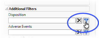

| 8 | Click from the Disposition filter. |

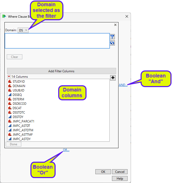

The Where Clause Builder opens.

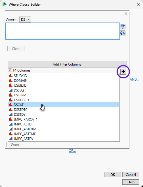

The DS domain is automatically selected as the domain. All of the columns in the domain are listed and are available for selecting.

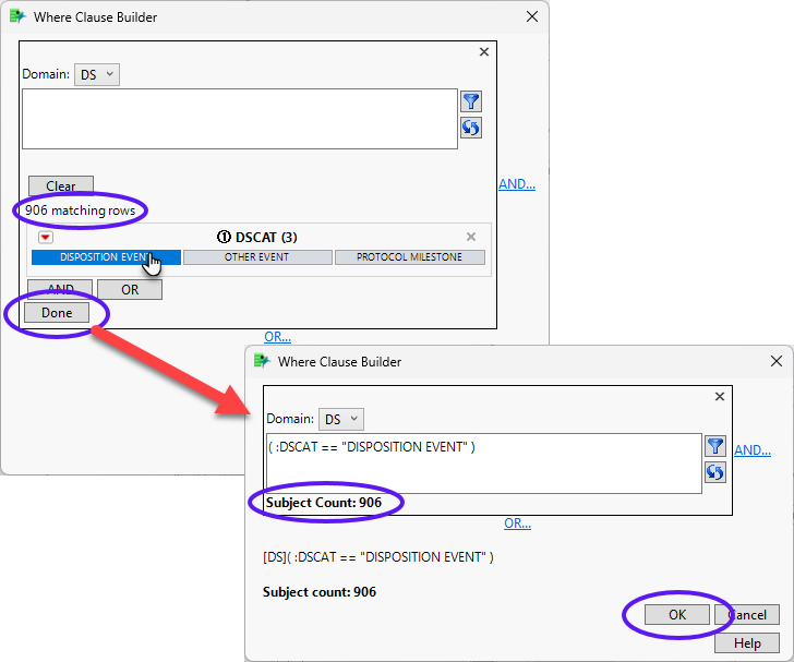

| 8 | Double-click on a column to select that column. In this example, we select DSCAT and click . |
The column list changes to a list of the different term categories contained in the selected column.
| 8 | Select DISPOSITION EVENT and click . You can see that we have selected 906 observations which account for the 906 subjects in the Nicardipine study. |

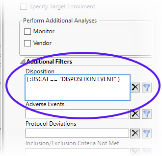

| 8 | Click to add the filter to the report. |

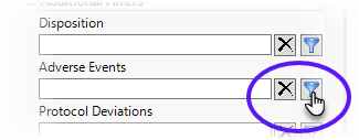

| 8 | Click from the Adverse Events filter. |

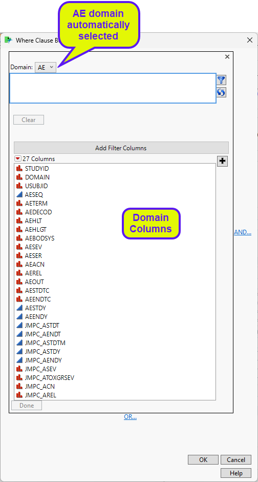

The AE domain is automatically selected as the domain. All of the columns in the domain are listed and are available for selecting.

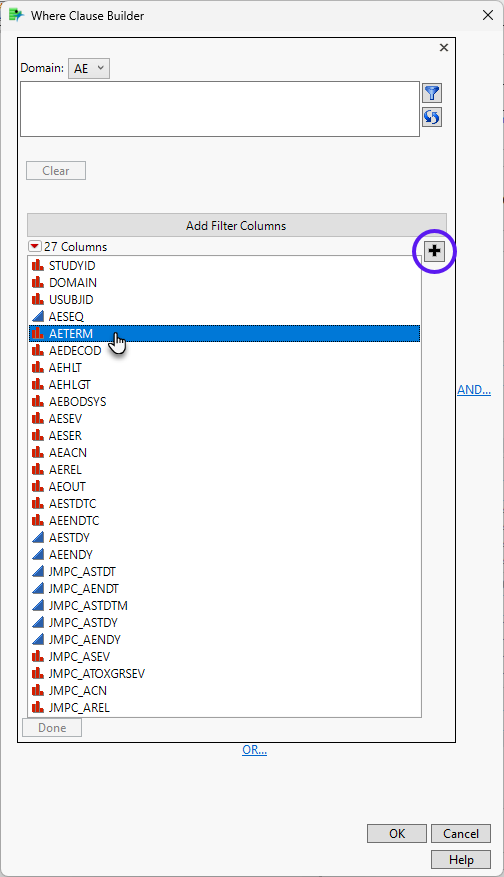

| 8 | Click on a column to select that column. In this example, we select AETERM and click . |

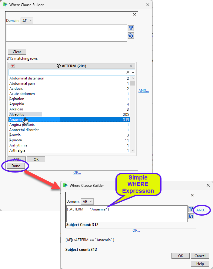

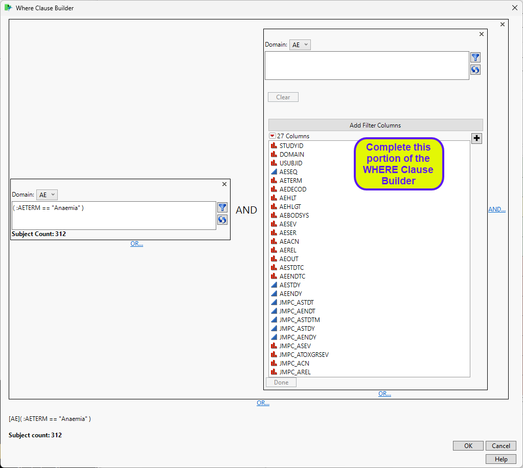

| 8 | Select Anaemia and click to generate the simple WHERE expression. |

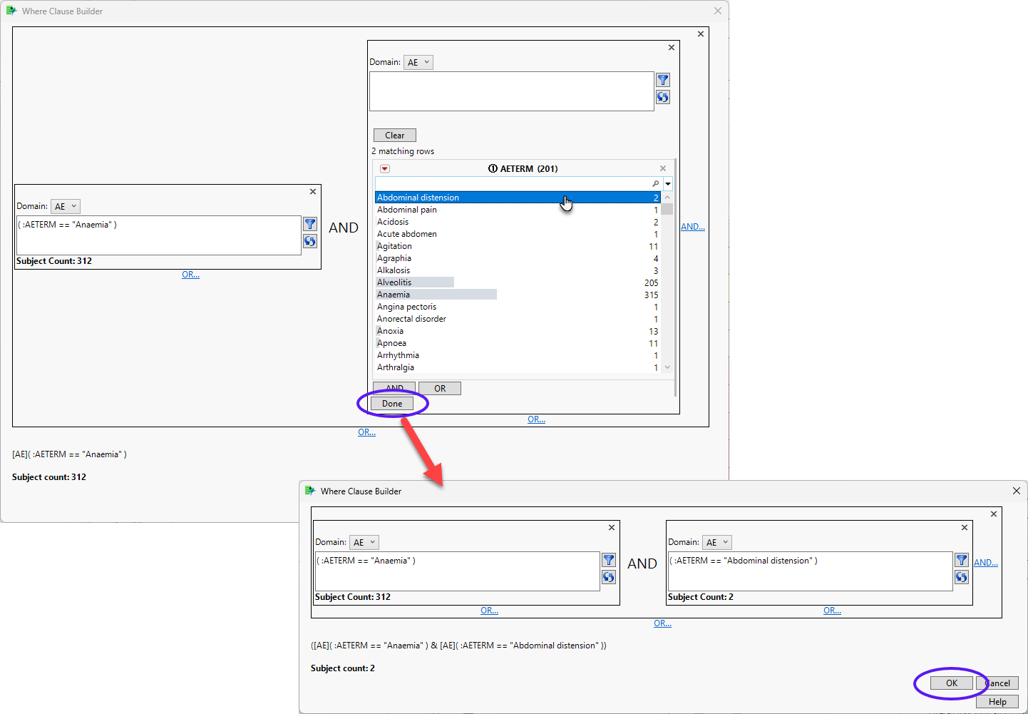

| 8 | Click (circled above) to generate a complex WHERE expression. |
To complete the second portion of the expression, where AETERM is Abdominal Distension:

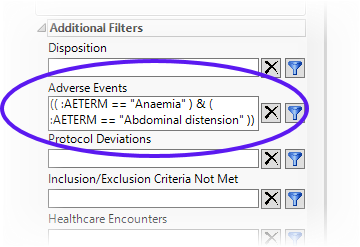

| 8 | Select AETERM and click . |
| 8 | Click . to add the WHERE expression is added to the filter in the report. |
