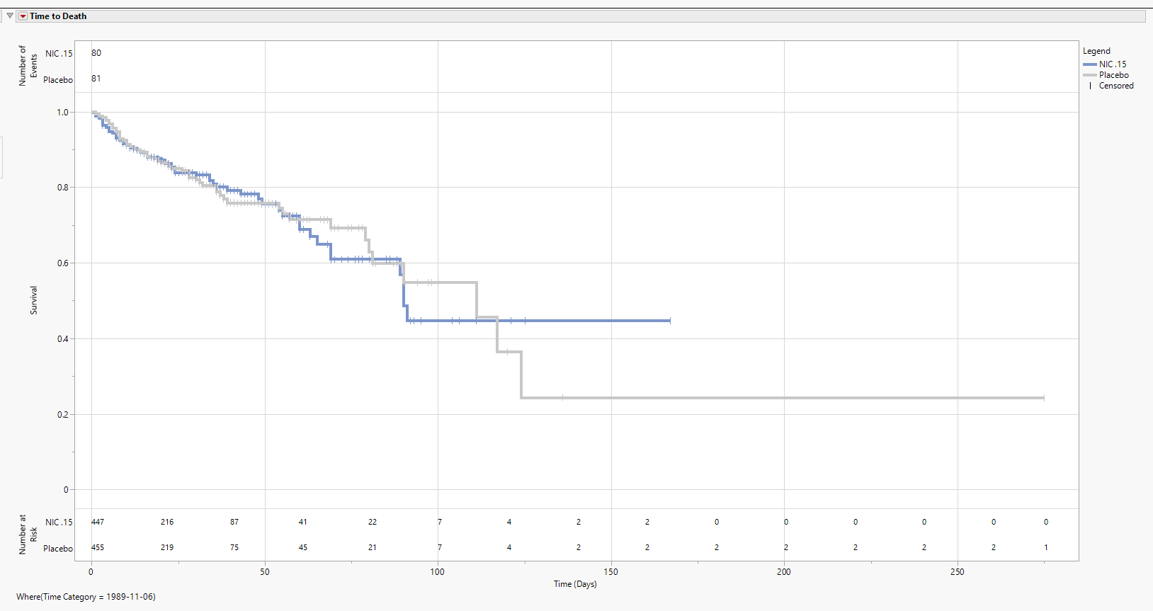

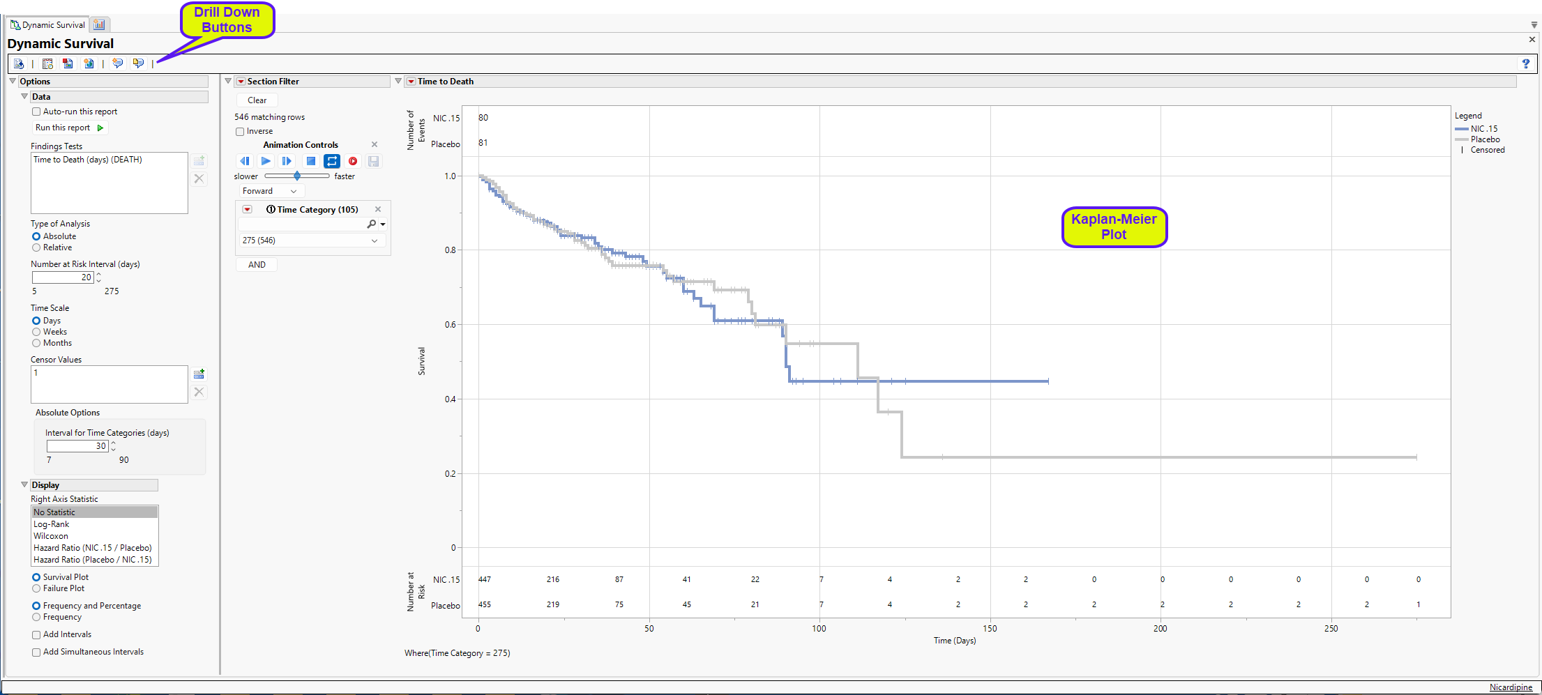

Running Dynamic Survival for Nicardipine using default settings generates the report shown below. Output from the report is organized into sections. Each section contains one or more plots, data panels, data filters, or other elements that facilitate your analysis.
The report displays a survival plot summarizing a Relative analysis of the Nicardipine Time to Death endpoint from ADTTE. Censored observations are represented by the vertical pipe symbols. At the top of the figure, the total Number of Events experienced for each arm are summarized; the bottom of the figure presents a table for the Number of Patients at Risk in 20-day increments.
Number at Risk
This section of the plot indicates the number of subjects in each treatment arm still participating in the study at each interval specified using the Number at Risk Interval (days) option.
Sectional Filter
This data filter enables you to subset subjects based on time and other factors. You can select Time Category in the filter and use the animation controls to play an animation of how the survival analysis will change over time. Refer to Data Filter for more information.

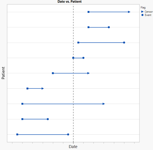

Absolute Time

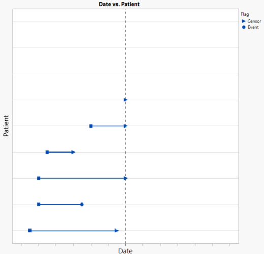

In this analysis, we observe survival data plotted by patient and date (see below). Each patient’s time (ADTTE.AVAL) is measured from a start date (ADTTE.STARTDT) to an end date (ADTTE.ADT) where the patient experiences an event (CNSR = 0) or is censored (CNSR > 0) for not having experienced an event prior to the end of follow-up.
Suppose there was interest in conducting an interim analysis at a date indicated by the dashed horizontal reference line. For this analysis, patients whose follow-up extends beyond this reference date would be censored at this date (see below). This interim analysis conducted using this data would include 6 patients, only one of whom had an event prior to the reference date.
While it is typical to preplan for a small number of interim analyses to assess the outcome for a survival endpoint, there may be interest in understanding how robust the results are to the timing of the interim analysis. What if the analysis had been conducted 2-weeks earlier? 4- weeks? How would the results change? An Absolute analysis from this report enables you to answer this question easily. Based on the value specified using the Interval for Time Categories (days) option, the analyst can recompute the survival analysis in 7-90 day intervals counting backwards from the observed maximum event/censor date (ADTTE.ADT). Time Category values include dates according to this interval as long as the date is greater than the minimum event/censor date. Because the analysis is based on absolute time, patients may be excluded from Time Categories.
The figure below is an Absolute analysis of the Nicardipine Time to Death endpoint from ADTTE. Censored observations are represented by the vertical pipe symbols. At the top of the figure, the total Number of Events experienced for each arm are summarized; the bottom of the figure presents a table for the Number of Patients at Risk in 20-day increments.

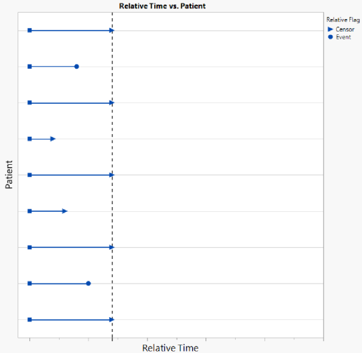

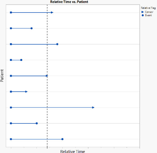

In contrast to the Absolute analysis described in Figure 2, the Relative analysis (see below) considers time within each patient relative to their start dates. Therefore, all patients start at time 0 (coinciding with ADTTE.STARTDT) and the number of days (most generally) to reach the event/censor date will coincide with ADTTE.ADT. In a manner similar to the Absolute analysis, suppose there was interest in conducting an analysis at a Relative time indicated by the dashed horizontal reference line.
For this analysis, patients whose follow-up extends beyond this reference time would be censored at this time (see below). Unlike the absolute analysis, this analysis would include every patient, as every patient is included in the analysis since time 0.

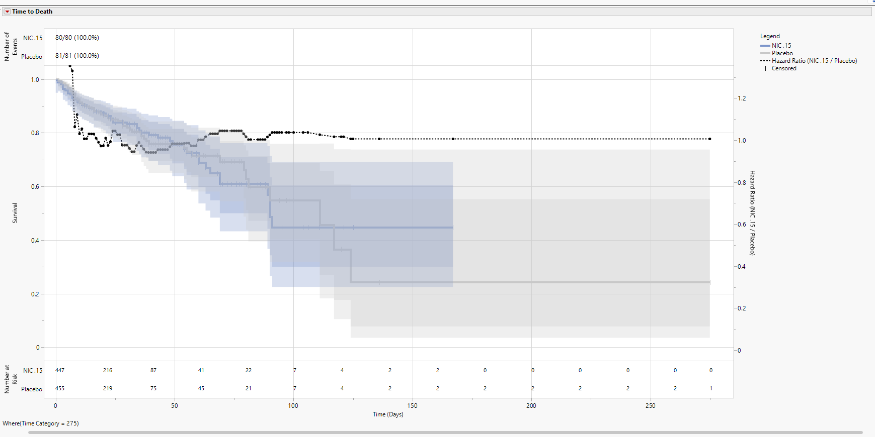

The figure below shows a Relative analysis for Nicardipine for Time Category 100 (which can be thought of as 100 days of follow-up from Time 0). Both confidence intervals have been added to the figure as well as a line for the hazard ratio for Nicardipine vs. Placebo. By day 100, there are 7 patients still at risk for each treatment arm, and the initial sample sizes coincide with the total sample sizes of treated patients in each arm. Notice that the Number of Events includes the proportion of Total Events experienced for each arm. By day 100, all 80 events have been experienced on the NIC.15 arm, and 78 of 81 events (96.3%) have been experience on Placebo, indicating that there are 3 events left to occur by the end of the analysis.
A Relative analysis makes it possible to view an animation and watch as the proportion of events grows over time. Note the Display tab has an additional button available called Frequency/Frequency and Percentage. This is to remove the percentages if it is of interest to save the plots for publication [saving 80/80 (100.0%) and 81/81 (100%) at the maximum Time Category isn’t particularly meaningful].

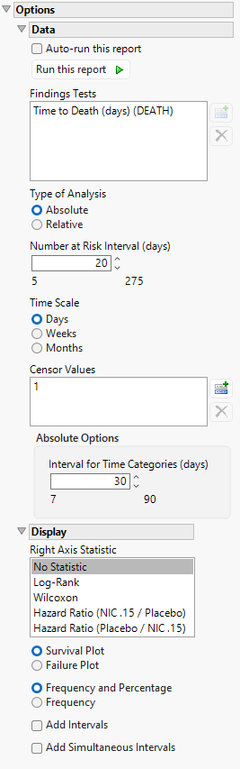

Options
Data
Auto-run this report
Check this box to auto-run the report upon launch. Previously saved settings are used.
Run this report
Use this widget to run this report after modifying any of the options. This option is not available when the Auto-run check box is checked.
Findings Tests
Use this widget to select specific Findings tests.
| 8 | Click to open the Add window (shown below) that lists available test names (shown below). |
| 8 | Select the desired test(s) and click to add them to the text box. |
Type of Analysis
This option enables you to specify whether to show survival numbers in absolute ( based on the actual date) or relative (based on the number days a participant has participated in the study) terms.
Enter the number of days comprising the block of time between study days where the number of subjects remaining in the study are reported.
Color Risk Table by Treatment
Use this option to color the numbers in the Risk Table by treatment.
Time Scale
Use this widget to specify the time scale to use for times. Options can include Hours, Days, Weeks, Months, and Years. Refer to Time Scale for more information.
Censor Values
Use this option to specify the flag value indicating whether a subject is censored and has left the study.
This option enables you to specify a value that is used to create time blocks for assessing survival.
This option is available only when Absolute is specified as the type of analysis.
Display
Right Axis Statistic
Use this option to overlay a selected statistical plot on the survival plot. You can plot either of the p-values (from the Survival platform) or hazard ratios (from the Fit Proportional Hazards platform) across time by adding a second y-axis
Survival/Failure Plot
This option enables you to toggle the display between showing a survival plot and failure plot.
Check Survival Plot to view a Kaplan-Meier plot. This curve is based on the survival function estimator calculated using clinical outcome data. It is used to measure the proportion of patients living for a given amount of time after treatment.
Check Failure Plot to display a failure plot, which contains overlaid failure curves (proportion failing over time) for each group. A failure plot, where the y-axis starts at 0 and increases upwards as events occur, reverses the vertical axis to show the number of failures rather than the number of survivors.
Use this option to specify whether to include percentage of surviving subjects in each treatment arm along the frequency. This option is enabled only when a relative analysis is run.
Add Intervals
Check this option to show the 95% pointwise confidence bands for the Kaplan-Meier survival functions in the Survival Plot and the Failure Plot. Meeker and Escobar (1998, ch. 3) discuss pointwise and simultaneous confidence intervals and the motivation for simultaneous confidence intervals in survival analysis.
Add Simultaneous Intervals
Check this option to show the 95% simultaneous confidence bands for the Kaplan-Meier survival functions in the Survival Plot and the Failure Plot. Meeker and Escobar (1998, ch. 3) discuss pointwise and simultaneous confidence intervals and the motivation for simultaneous confidence intervals in survival analysis.
