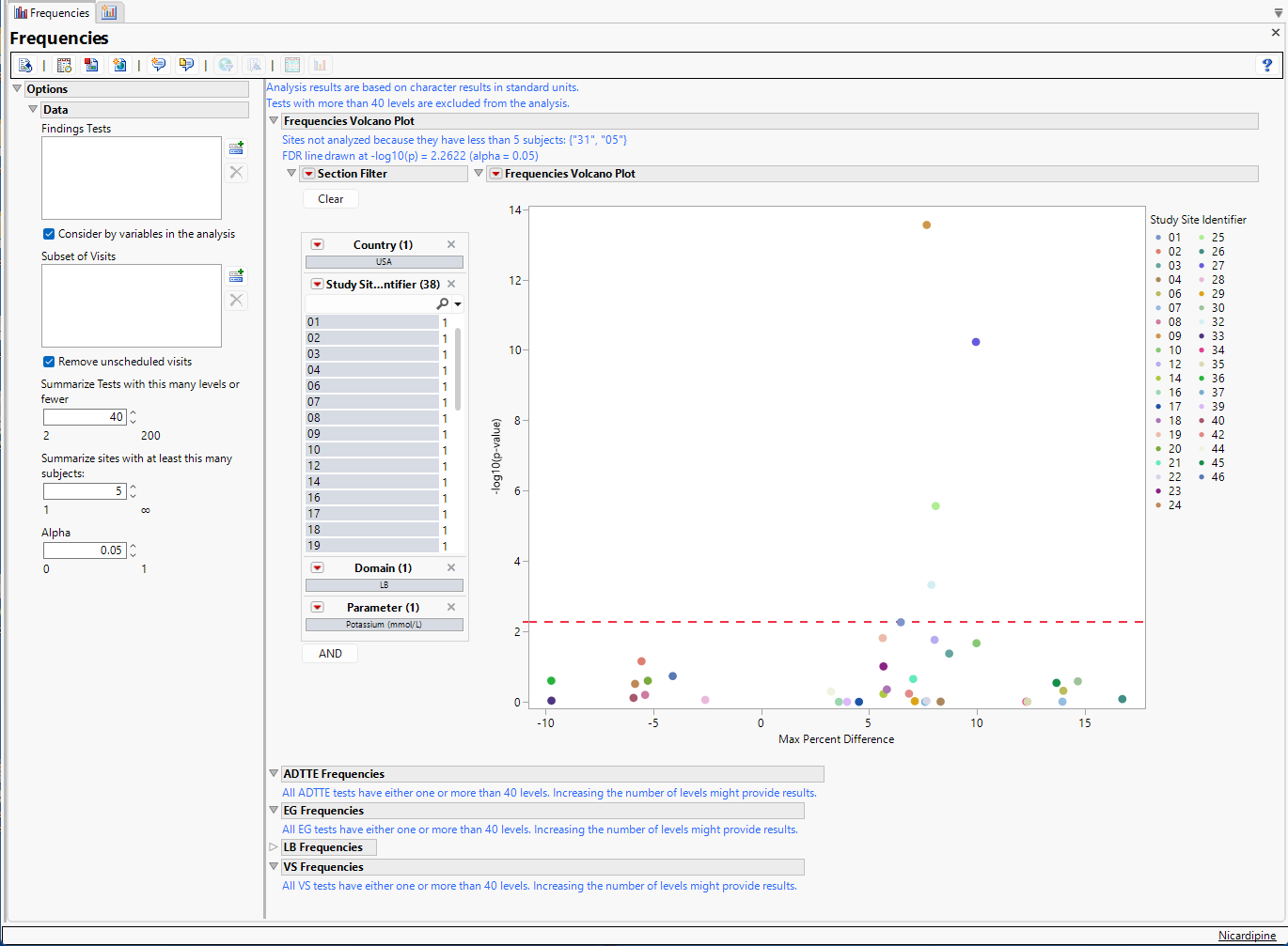

Running this report with the Nicardipine sample setting returns the following error message: Error running report All tests have either one or more than 5 levels. Increasing the number of levels might provide results. Increasing the number of levels to 40 provides output which is described in the rest of this section.
The Report contains the following elements:
Frequencies Volcano Plot
Shows a volcano plot used to determine the deviation of the proportion of findings frequencies at each site with the overall proportions for the findings across the whole study.

| • | One Volcano Plot. |

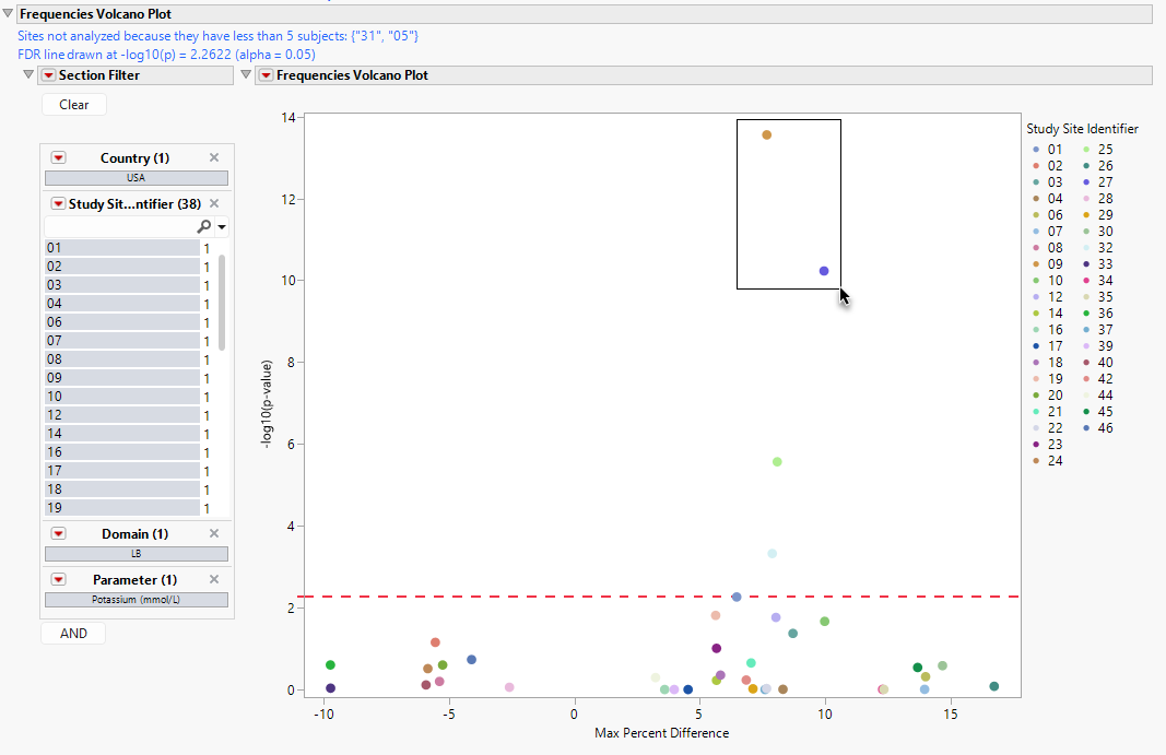

The volcano plot is used to determine the deviation of the proportion of findings frequencies at each site with the overall proportions for the findings across the whole study. Each “dot” represents a single Findings test for a specific site, which is compared to a reference (all other sites).The X axis represents the maximum difference in proportions between each value of the Findings test between the site and the reference set (all other sites).
You can mouse over points of interest to see their labels or select points by dragging a mouse rectangle over them (as shown above). Selected rows are highlighted in other plots and you can also then click on various Drill Down Buttons for further analyses on those specific sites. For example, if you click

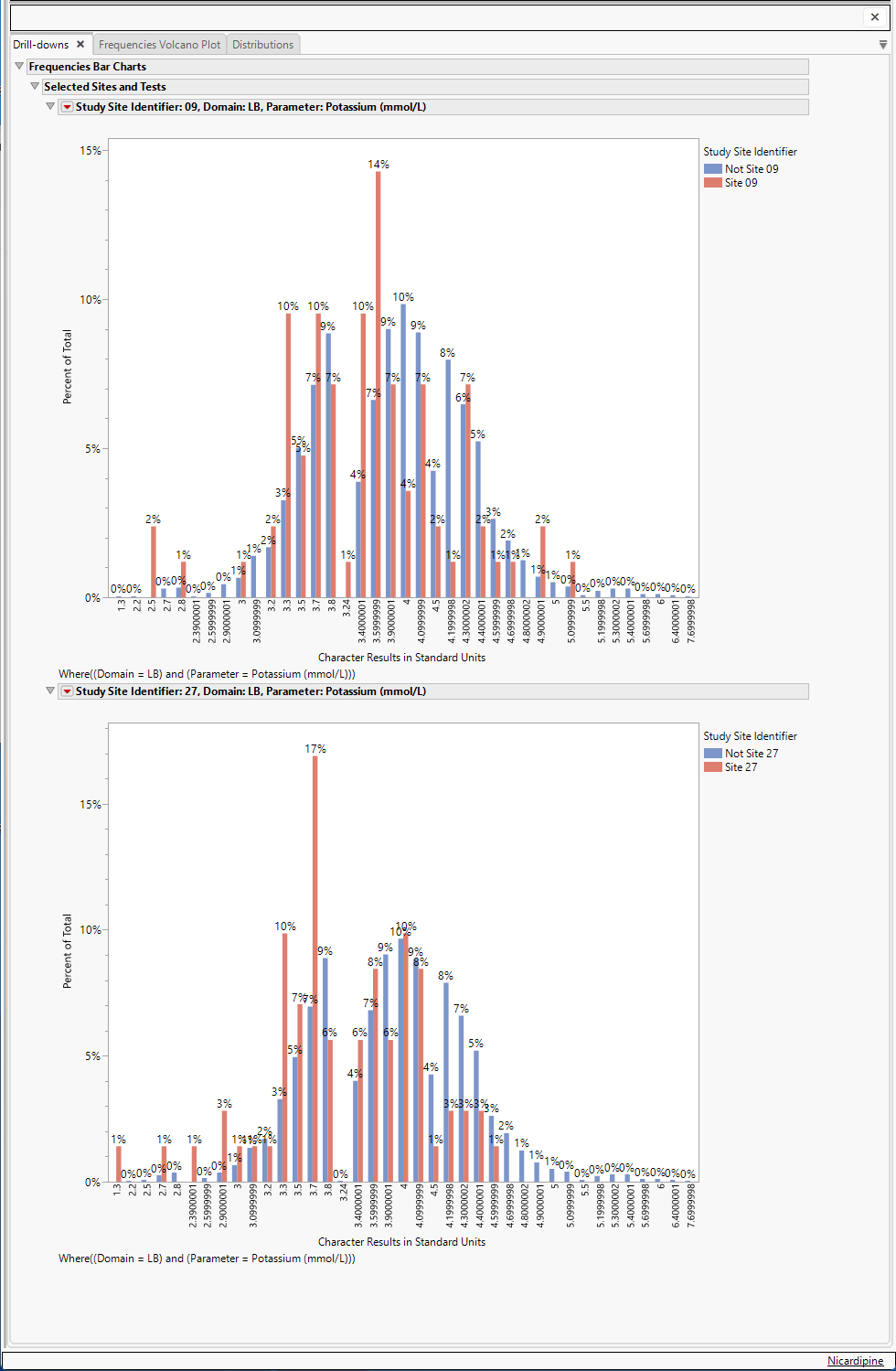

, the following opens with comparisons of sites 09 and 27 with all sites not site 09 and 27, respectively.

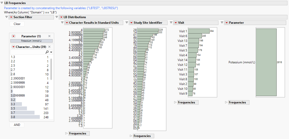

LB Frequencies
Displays histograms summarizing lab test findings across the study.
This section contains the following elements.
| • | Section Filter: Enables you to filter data to specific values of the test result. |
| • | Distributions: Displays histograms showing distributions of laboratory test findings, study site and visit. |

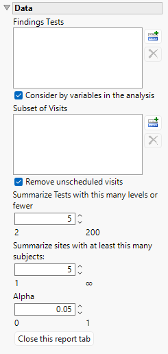

Data
Findings Tests
Use this widget to select Findings Tests for the analysis. The report will autorun and analysis is restricted to the selected tests only.
Consider BY variables in the analysis
You can opt to Consider BY variables in the analysis. This option, which assumes that BY variables (left vs. right arm for collecting blood pressure data, for example) are included in the experimental design, is selected by default. You can uncheck this option to ignore BY variables.
Subset of Visits
Use the Subset of Visits option to select the visits to be included in the analysis.
Remove unscheduled visits
You can restrict the analysis to data from scheduled visits by checking the Remove unscheduled visits box.
Summarize tests with this many levels or fewer:
Use this option to specify the maximum number of distinct levels or values a findings test may have to be included in the analysis.
Note: A findings test must have at least 2 levels.
Summarize sites with at least this many subjects:
The Summarize sites with at least this many subjects: widget enables you to set a minimal threshold for the sites to be analyzed. Only those sites which exceed the specified number of subjects are included. This feature is useful because it enables you to exclude smaller sites, where small differences due to random events are more likely to appear more significant than they truly are. In larger sites, observed differences from expected attendance due to random events are more likely to be significant because any deviations due to random events are less likely to be observed.
Note: This option applies only to the volcano plot. The distribution plots still include all sites regardless of how this option is specified.
Alpha
The Alpha option is used to specify the significance level by which to judge the validity of the statistics generated by this report. By definition, alpha represents the probability that you will reject the null hypothesis when the null is, in fact, true. Alpha can be set to any number between 0 and 1, but is most typically set at 0.01, 0.05, or 0.10. The higher the alpha, the lower your confidence that the results you observe are correct.

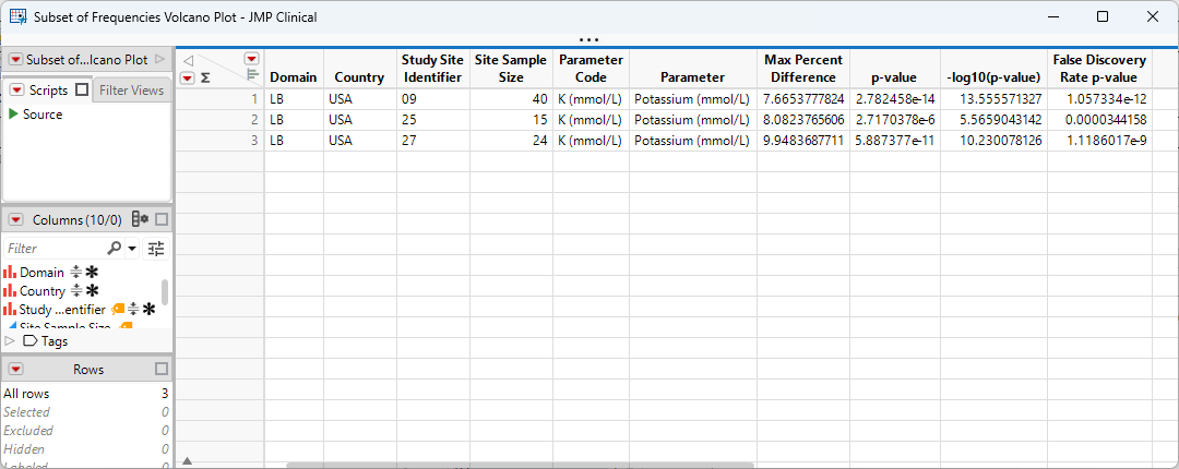

| • | Show Sites: Shows the rows of the data table for the selected points from the volcano plot. Clicking opens the following table: |
| • | Frequency Bar Chart: Select points on the volcano plot and click to display a bar chart for each point showing the proportions of each value of the Findings Test for the site as compared to the distribution of all of the other sites combined. |
