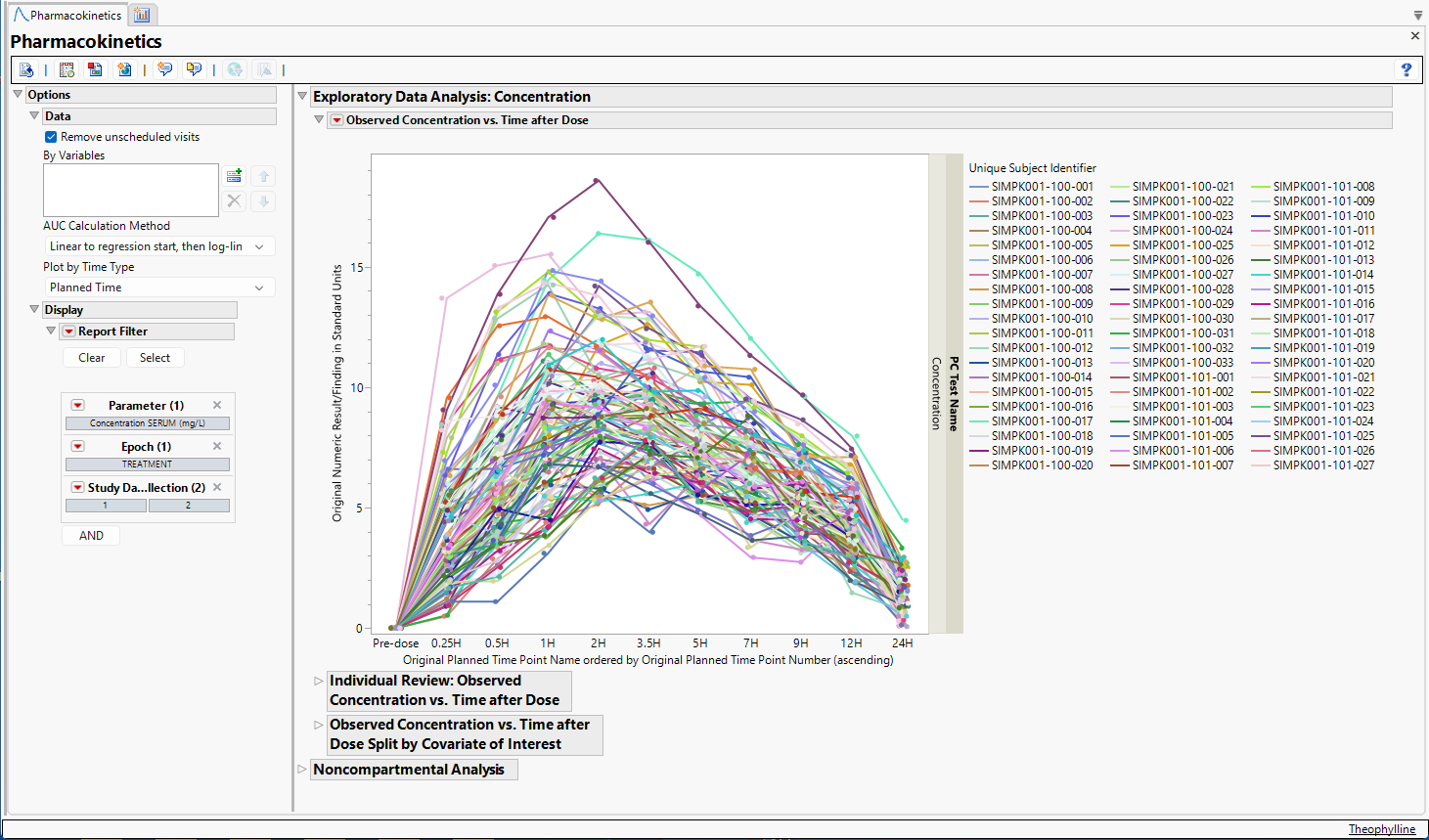

Exploratory Data Analysis
Observed Concentration vs. Time after Dose
This plot displays observed concentrations for the Theophylline data by the planned time after dose for each patient in the trial.

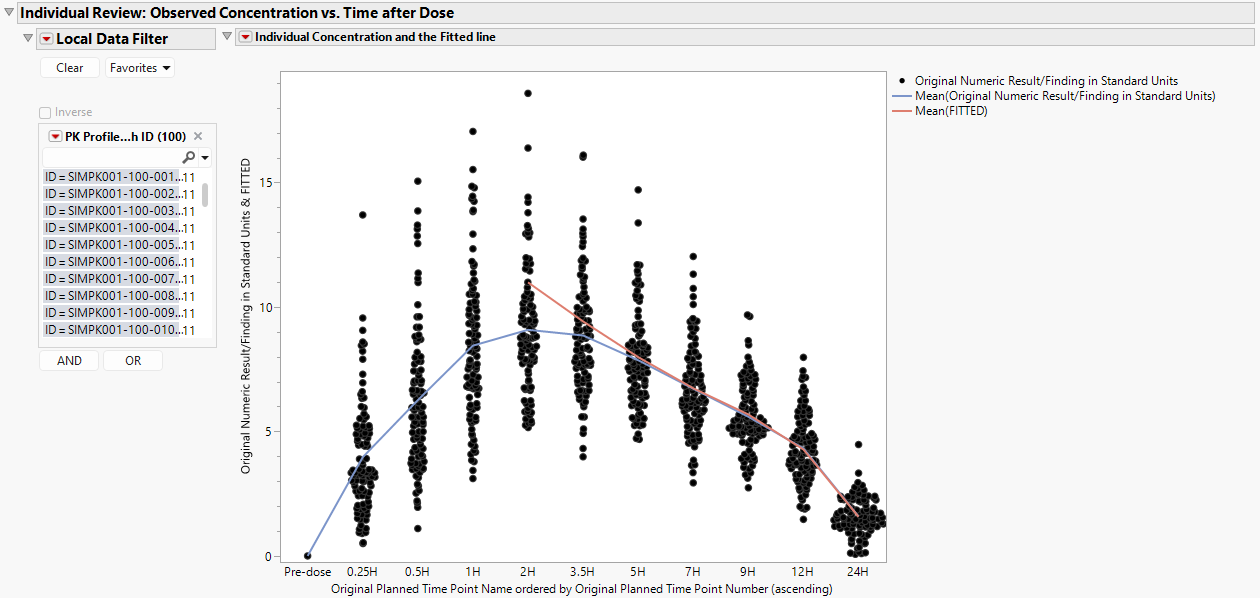

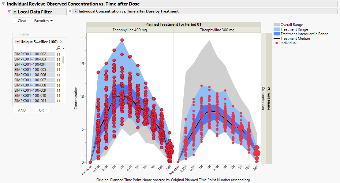

Individual Review - Observed Concentration vs Time after Dose
This plot displays concentration data by treatment for each patient (red dots), with shaded areas describing the overall range of concentration data (gray), the treatment-specific range of concentration data (light blue), and the treatment-specific interquartile range of concentration data (dark blue), along with the treatment-specific median concentration curve (black) and the individual concentration curve (red), which summarizes the mean concentration when more than one patient is presented.
The Local Data Filter can be used to subset to an individual patient to view their particular pk concentration profile. This view makes it possible to assess the individual’s pharmacokinetics in the context of the entire treatment arm as well as across all patients.

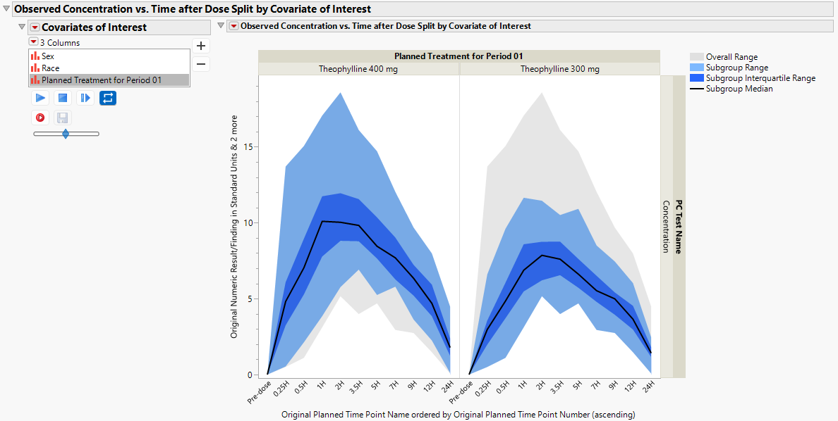

Observed Concentration vs. Time after Dose Split by Covariate of Interest
Concentration data can be further summarized by treatment group (default). In the figure below, the subgroup-specific range of concentration data (light blue), and the subgroup-specific interquartile range of concentration data (dark blue) are presented, along with the subgroup-specific median concentration curve (black).
Concentration data can be further summarized and presented by demographic subgroups, such as race.

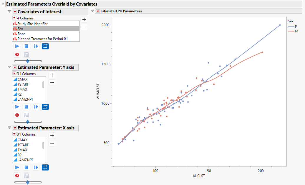

Estimated Parameters Overlaid by Covariates
The scatter plot enables you to view pairs of PK parameters with non-parametric curves to assess their bivariate relationship.

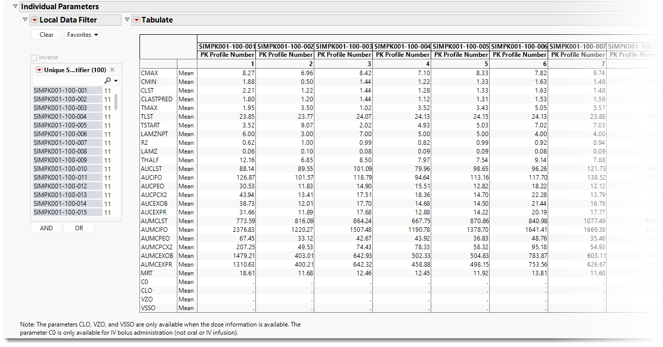

Individual Parameters
The following label lists computed parameters for each patient.
Computed parameters include the following:
