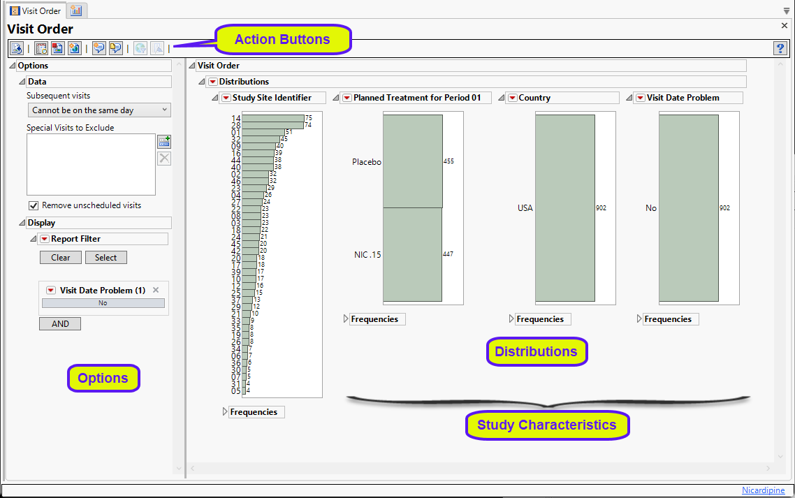

This report determines whether visit dates are unusual for subjects when ordering dates according to visit number.
Report Results Description
Running Visit Order with the Nicardipine sample setting and default options generates the report shown below:
The report contains the following elements:
| • | A series of histograms summarizing the number of subjects in various study sites, treatment arms, and countries. |
| • | A histogram showing the number of visit dates that might be unusual or problematic. In the example shown here, none of the visit dates were considered problematic. |

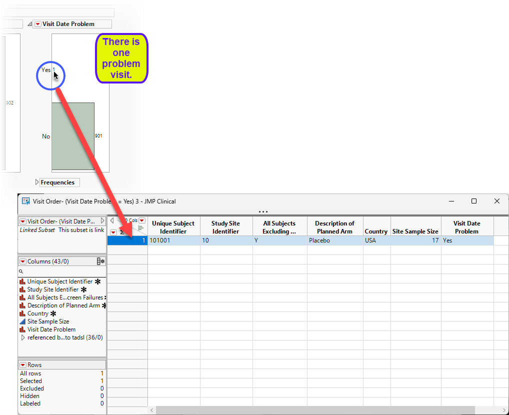

In the example shown above, there were no problem visits identified. How would you know if there was one? Let's find out:
In the following example, the Nicardipine study data files were copied into a new Study folder called NicardipineProblemVisit . The SV domain was opened and the date of the first study visit was changed from 1988-1-21 to 1988-1-26, as shown below. The new study was added as described in Add Study....
This date comes after the dates of 4 subsequent visits.
The Visit Order report was run for this study. The Visit Date Problem histogram is shown below:
| 8 | Double-click on the Yes column and click to open a table listing the USUBJID, study site(s) and other information about the subject(s) with the problem visit dates. Problematic dates are indicated with a "1". |

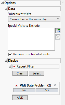

Options
Data
Subsequent Visits
The Subsequent visits option is used to specify whether multiple visits on the same day should be considered as separate visits. If same-day visits should not be considered as separate visits, those identified as occurring on the same day are flagged.
Special Visits to Exclude
Use the Special visits to exclude option to exclude those visits which, based on the numbering scheme, will trigger an alert. This is useful for special visit codes such as for unscheduled or early discontinuation visits, which can be coded as 98 or 99, respectively.
Remove unscheduled visits
Unscheduled visits can occur for a variety of reasons and can complicate analyses. By default, these are excluded from this analysis. However, by unchecking the Remove unscheduled visits box, you have the option of including them.
Display
Report Filter
This enables you to subset subjects based on demographic characteristics and Standardized Disposition Terms. Refer to Data Filter for more information.
