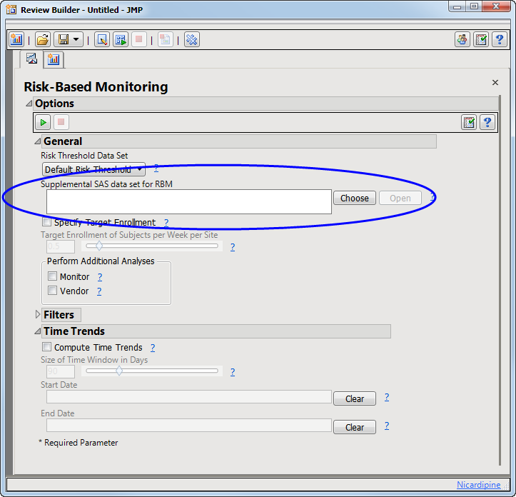

A supplemental data can be specified through the Risk-Based Monitoring dialog (circled below).
By default, JMP Clinical looks first in the RBMSupplemental subfolder found in the user folder (typically located in the C:\Users\username\AppData\Roaming\SAS\JMPClinical\12\JMPC\RBMSupplemental directory), although supplemental data sets can be stored anywhere.

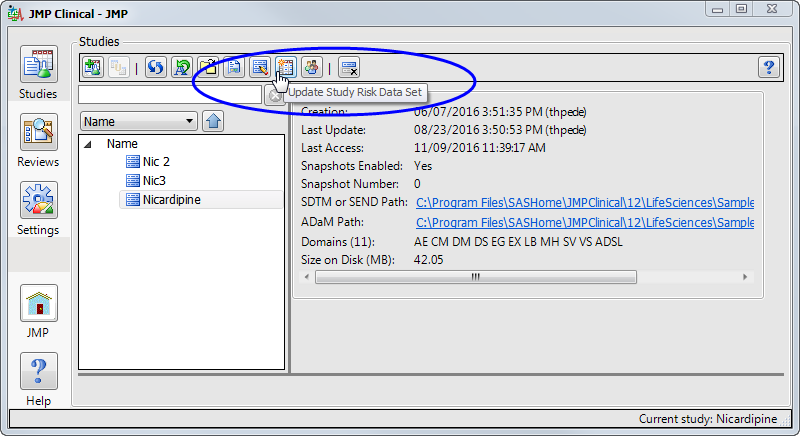

The Update Study Risk Data Set option is accessed using an action button on the Studies tab of the JMP Clinical Main . (See below.)

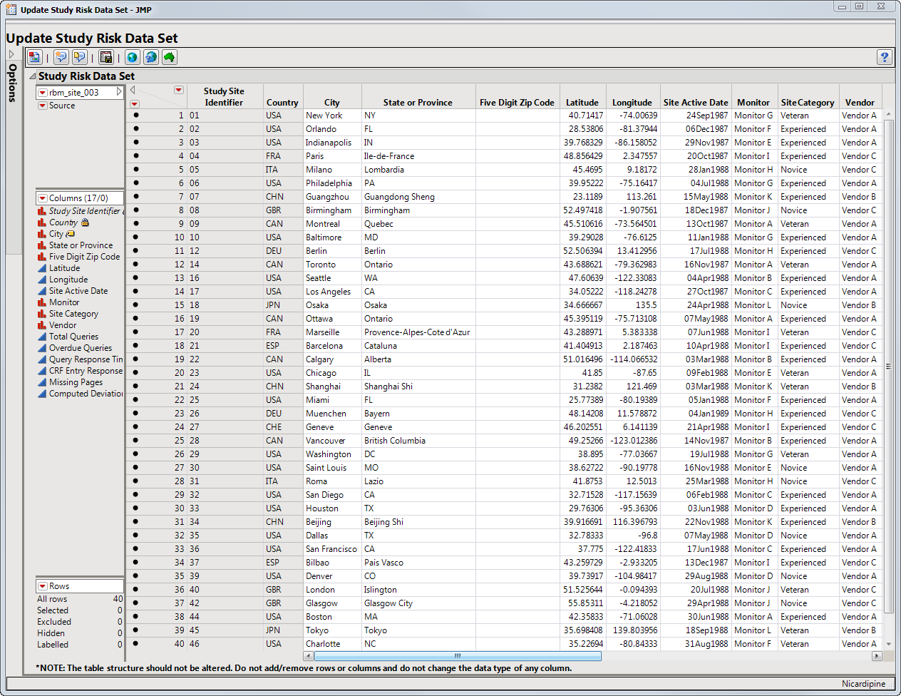

Clicking this action button opens the Study Risk data set (shown below). Note that only site level classifications are supplied.

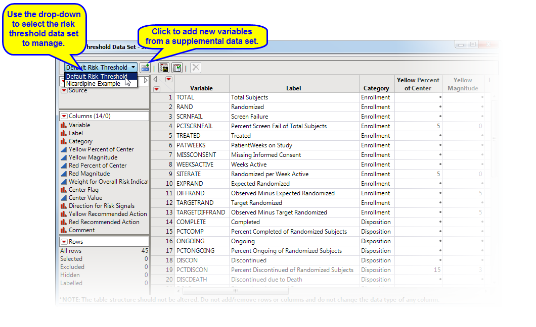

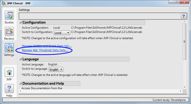

To add supplemental indicators, you first need to manage risk threshold data sets (which enables you to delete, update, or add new variables to a base risk threshold data set). The Risk Threshold data set is accessed from a link on the Settings tab of the JMP Clinical Main (below).
Clicking Manage Risk Threshold Data Sets... opens the default risk threshold data set (shown below).

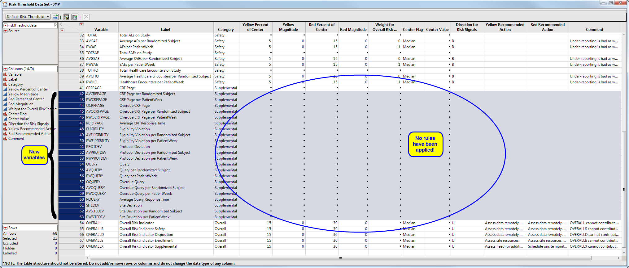

To add new variables from a supplemental data set, click . An Add variables from supplemental data opens. Click to open a Select a SAS data set showing the contents of the supplemental data set folder. Select the desired supplemental data set and click . Return to the Add variables from supplemental data and click .
This report adds a number of additional variables (Supplemental, because this is the defined Category in the rb_en.sas7bdat data set). This data set can now have rules applied to the variables and can be saved with a new name to be used by theRisk Based Monitoring report. Note that the only difference between the data set shown below and the Nicardipine Example risk threshold data set is that there are no rules defined in the data set shown below. The data set as defined below enables an analysis of the supplemental data, but without any coloring of the risk indicators according to any rules.
