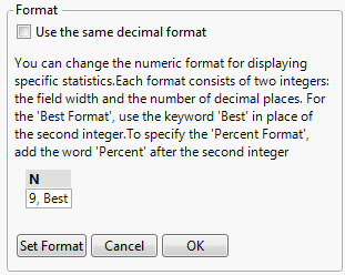

Click the Change Format button at the bottom of the Tabulate window.
5.
Click OK to implement the changes and close the Format section, or click Set Format to see the changes implemented without closing the Format section.
