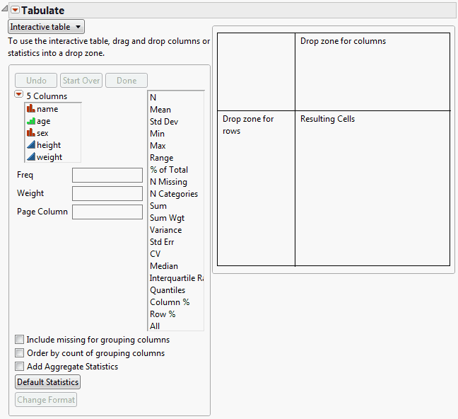

To launch the Tabulate platform, select Analyze > Tabulate.
Switch between the two modes. Use the interactive table mode to drag and drop items, creating a custom table. Use the dialog mode to create a simple table using a fixed format. See Use the Dialog.
Lists standard statistics. Drag any statistic from the list to the table to incorporate it. See Add Statistics.
Generates separate tables for each category of a nominal or ordinal column. See Example Using a Page Column.
Enables you to change the numeric format for displaying specific statistics. See Change Numeric Formats.
(Only appears if Show Chart is selected from the red triangle menu.) Enables you to specify a uniform custom scale.
(Only appears if Show Chart is selected from the red triangle menu.) Deselect this box for each column of bars to use the scale determined separately from the data in each displayed column.
