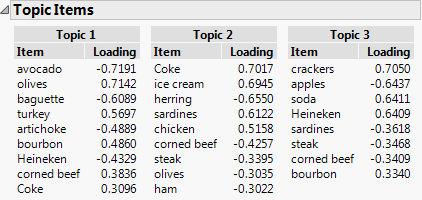

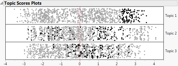

In this example, you use singular value decomposition of the transaction item matrix to gain further insight into the Grocery Purchases.jmp sample data.
Select Analyze > Screening > Association Analysis.
5.
Click OK.
7.

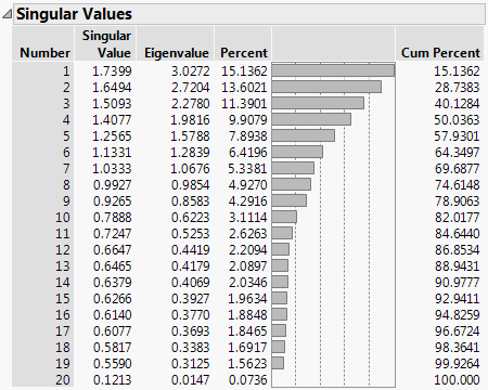

As seen in Singular Values Table, the first two singular values explain only about 30% of the variability in the grocery store data. Additional dimensions might be required to explain a sufficient amount of variability.
