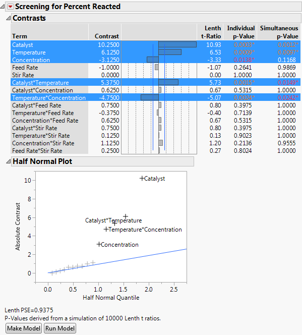

For this example, select all continuous factors, except the response, Percent Reacted, as the screening effects, X. Select Percent Reacted as the response Y. The screening platform constructs interactions automatically. This is in contrast to Fit Model, where you manually specify the interactions that you want to include in your model.

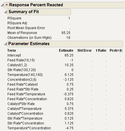

Traditional Saturated Half Reactor.jmp Design Output shows the result of using the Fit Model platform, where a factorial to degree 2 model is specified. Since there are not enough observations to estimate an error term, it is not possible to conduct standard tests.
JMP can calculate parameter estimates, but because there are no degrees of freedom for error, standard errors, t-ratios, and p-values are all missing. Rather than use Fit Model, you can use the Fit Two Level Screening platform, which specializes in getting the most information out of these situations, leading to a better model. The report from the Fit Two Level Screening platform for the same data is shown in Half Reactor.jmp Fit Two Level Screening Design Report.
Estimates labeled Contrast. Effects whose individual p-value is less than 0.10 are highlighted.
A t-ratio is calculated using Lenth’s PSE (pseudo-standard error). The Lenth PSE is shown below the Half Normal Plot.
Both individual and simultaneous p-values are shown. Those that are less than 0.05 are shown with an asterisk.
The Make Model button opens the Fit Model window and populates it with the selected effects. The Run Model button runs the model based on the selected effects.
For this example, Catalyst, Temperature, and Concentration, along with two of their two-factor interactions, are selected.
