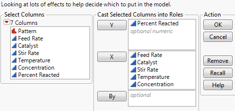

Select Analyze > Specialized Modeling > Specialized DOE Models > Fit Two Level Screening.
Click OK.

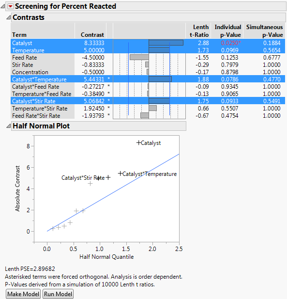

If all effects are inactive, their estimates are random normal noise. Their estimates (contrasts) should fall close to the line shown in the Half Normal plot in Screening Report. Effects that fall far from the line are likely not noise, and so may represent active effects. Note that effects with Individual p-Values that fall below 0.10 are highlighted in the Contrasts outline. These effects are labeled in the Half Normal Plot and then tend to fall far from the line.
