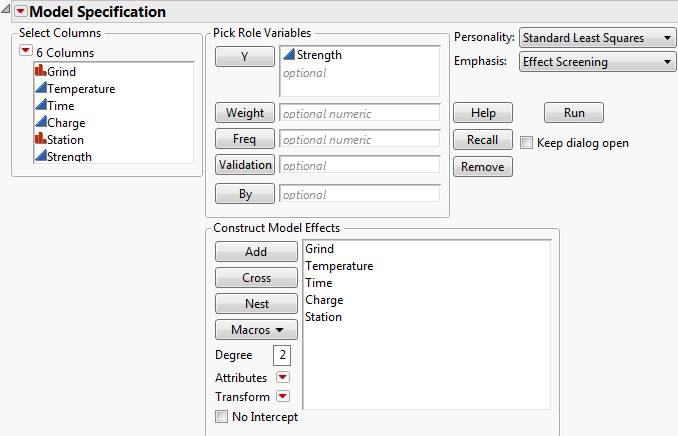

Model Specification Window
Select the Keep dialog open option.
Click Run.

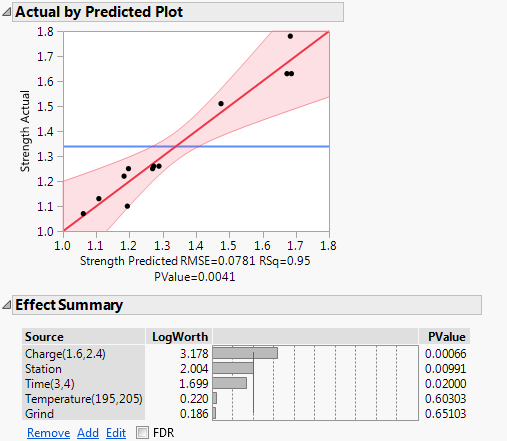

Effect Summary and Actual by Predicted Plot for Full Model
The model is significant, as indicated by the Actual by Predicted Plot. The notation P = 0.0041, shown below the plot, gives the significance level of the overall model test.
The Effect Summary report shows that Charge, Station, and Time are significant at the 0.05 level.
The Effect Summary report also shows that Temperature and Grind are not significant.
Because Temperature and Grind appear not to be active, they contribute random noise to the model. Refit the model without these effects to obtain more precise estimates of the model parameters associated with the active effects.
In the Model Specification window, select Temperature and Grind in the Construct Model Effects list.
Click Remove.
Change the Emphasis to Effect Screening.
Click Run.

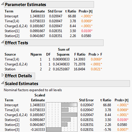

Partial Results for Reduced Model

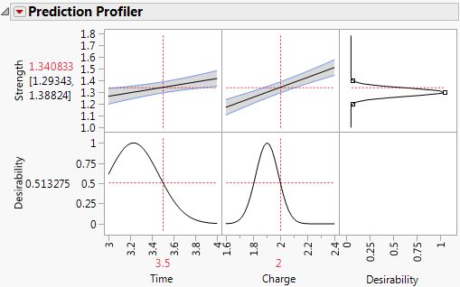

Prediction Profiler
The first two plots in the top row of the graph show how Strength varies for one of the factors, given the setting of the other factor. For example, when Charge is 2, the line in the plot for Time shows how predicted Strength changes with Time.
The values to the left of the top row of plots give the Predicted Strength (in red) and a confidence interval for the mean Strength for the selected factor settings.
The right-most plot in the top row shows the desirability function for Strength. The desirability function indicates that the target of 1.3 is most desirable. Desirability decreases as you move away from that target. Desirability is close to 0 at the limits of 1.2 and 1.4.
Explore various factor settings by dragging the red dashed vertical lines in the columns for Time and Charge. Since there are no interactions in the model, the profiler indicates that increasing Charge increases Strength. Also, Strength seems to be more sensitive to changes in Charge than to changes in Time.

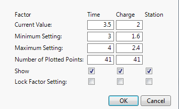

Since Station is a blocking factor, it does not appear in the Prediction Profiler. However, you might like to see how predicted Strength varies by Station. To include Station in the Prediction Profiler, follow these steps:
A Factor Settings window appears with columns for Time, Charge, and Station. Under Station, notice that the box corresponding to Show is not selected. This indicates that Station is not shown in the Prediction Profiler.
Select the box under Station in the row corresponding to Show.
Deselect the box under Station in the row corresponding to Lock Factor Setting.
Factor Settings Window

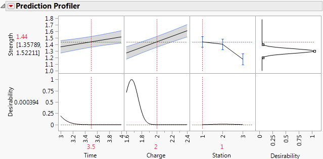

Plots for Station appear in the Prediction Profiler.
5.
Click in either plot above Station to insert a dashed red vertical line.
Prediction Profiler Showing Results for Station 1
Prediction Profiler Showing Results for Station 3
The predicted Strength in the center of the design region for Station 1 is 1.44. For Station 3, the predicted Strength is about 1.18. The magnitude of the difference indicates that you need to address Station variability. Better control of Station variation should lead to more consistent Strength. Once Station consistency is achieved, you can determine common optimal settings for Time and Charge.
