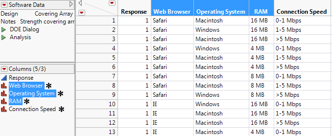

Now that you have your design table, you can conduct your experiment and record your data in the Response column of the design table (Design Table for Software Factors). Your experimental results are in the Software Data.jmp sample data table.
In the Table panel, click the green triangle next to the Analysis script.

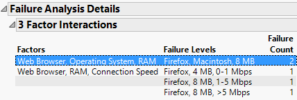

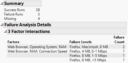

Two failures were associated with Web Browser set to Firefox, Operating System set to Macintosh, and RAM set to 8 MB. Notice that this combination led to failure regardless of the setting of Connection Speed.
Three failures were associated with combinations of Web Browser, RAM, and Connection Speed. Note that two of these failures, Firefox, 8 MB, 1-5 Mbps and Firefox, 8 MB, >5 Mbps, are among the two failures for the Web Browser, Operating System, and RAM interaction. Selecting any of these rows in the report selects the corresponding rows and columns in the data table.
