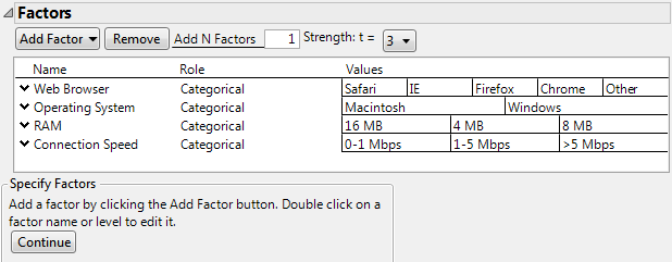

Select DOE > Special Purpose > Covering Array.
From the menu next to Strength: t = , select 3.
Factors Outline for Software Factors
5.
Click Continue.
6.

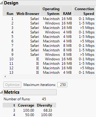

Click Make Design.
Design and Metrics Outlines for Software Factors
In the Metrics outline, consider the row that corresponds to t = 3. The Coverage is 100%, indicating that the design covers 100% of the three-factor interactions. This is what you want, because you requested a Strength 3 design. For t = 3, the Diversity column indicates that 68.33% of the three-factor interactions that appear are distinct. There is some minor repetition of three-factor combinations.
For t = 4, the Coverage is 50%, indicating that the design covers half of the four-factor interactions. There are 90 possible distinct combinations of the four factor settings. The 45 runs in the design comprise one-half of these distinct combinations. The Diversity value of 100% reinforces the fact that none of the four-way interactions are repeated.

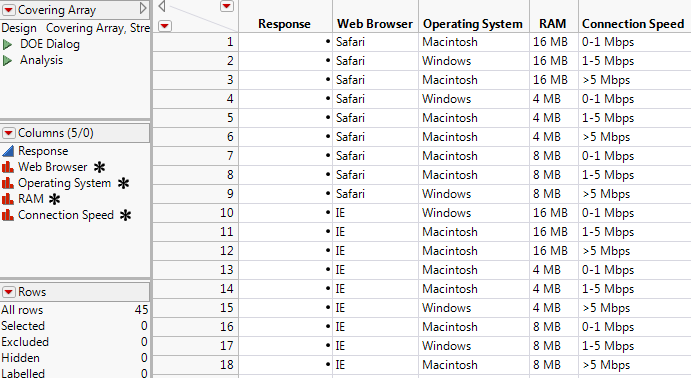

7.
Click Make Table.
Design Table for Software Factors
