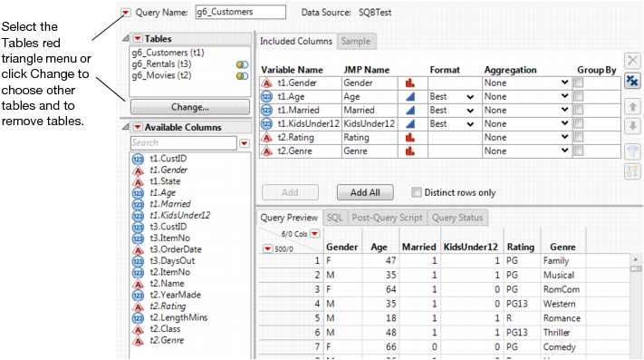

Select File > New > Database Query, connect to the database, and select the SQBTest schema. (See Connect to a Database for details.)
Click Build Query to show the Query Builder window.
5.
In the Available Columns box, select t1.Gender, t1.Age, t1.Married, t1.KidsUnder12, t2.Rating, and t2.Genre.
6.
Click Add on the Included Columns tab.
Tip: To find a column in a long list, enter the name in the search box below Available Columns. The red triangle menu provides options for matching case and searching with regular expressions. To hide the search box, deselect Show Search Box from the Available Columns red triangle menu.

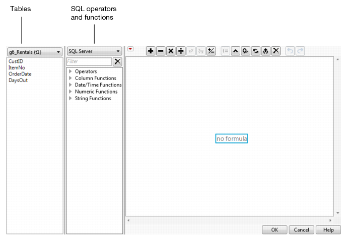

From the Available Columns red triangle menu, select Add Computed Column.
The Computed Column window appears (Computed Column Window with Formula Editor). The window contains the JMP Formula Editor.
Operators and functions are provided in the list on the right side of the Formula Editor (Computed Column Window with Formula Editor). In some instances, you might need to change the server type based on your database.
The Operators list does not provide a Concatenate (||) operator. You must type the formula in the Formula Editor box.

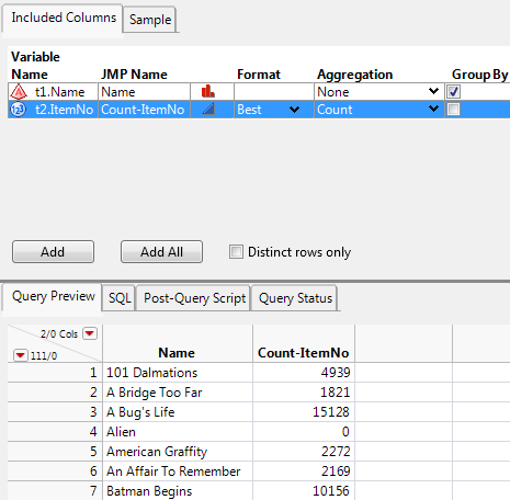

In the Select Tables for Query window, select g6_Movies as the Primary table and g6_Rentals as the Secondary table.
5.
The Group By check box is selected for t1.Name (Grouped Columns). All instances of a specific movie name will be grouped into one row.
6.
Click Run Query to import the data.
7.
To clear the grouped rows, select None from the column’s Aggregation list.

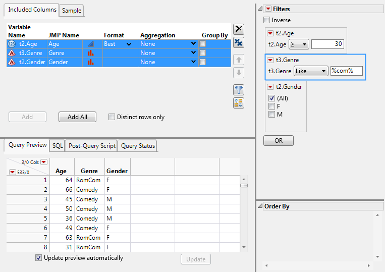

Set the t2.Age filter to ≥ 30.
8.
The % wildcards match any number of characters before and after “com”. On the Query Preview tab, notice that movies in both the RomCom and Comedy genres are shown (Selecting Filters).
9.
In the Filters red triangle menu, select All Prompt on Run.
10.
Click Run Query.
11.
In the Query Prompts window, click OK to apply the preselected filters and import the data.

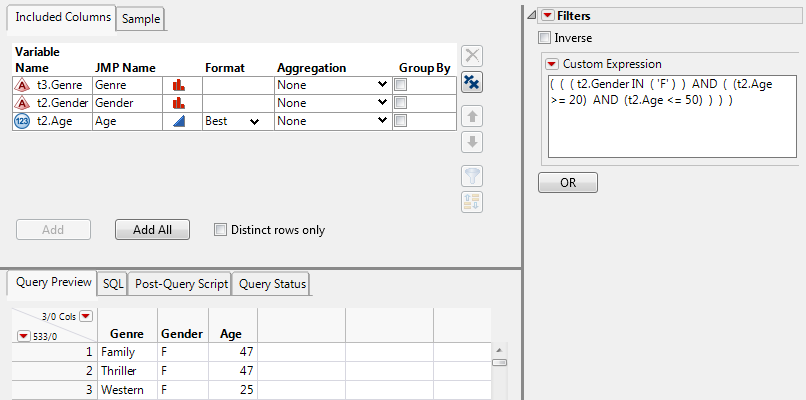

From the Filters red triangle menu, select Add Custom Expression.
( ( ( t2.Gender IN ( 'F' ) ) AND ( (t2.Age >= 20) AND (t2.Age <= 50) ) ) )

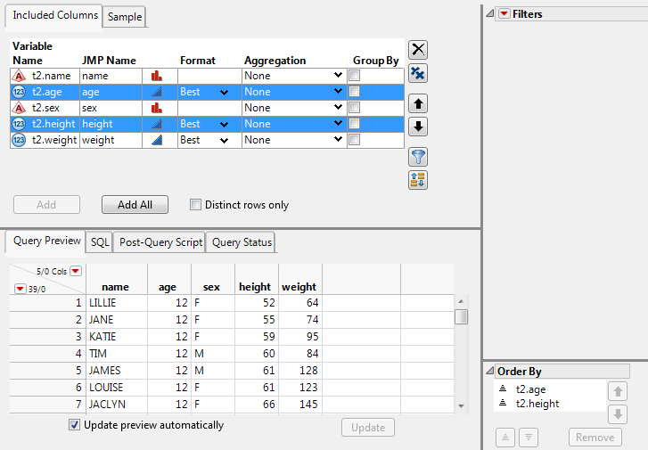

On the Included Columns tab, click Add All.
5.
6.

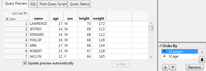

In the Order By outline, select t1.height and then click Sort the values in descending order
The height column is sorted from tallest to shortest.
7.
The height column is sorted first. Values in the age column are sorted within each level of height. For a height of 68, age is sorted from 14 to 17.
