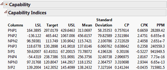

The Capability Indices Report option shows or hides a table showing each variable’s LSL, Target, USL, Mean, Standard Deviation, Cp, CPK, and PPM. Capability Indices shows the Capability Indices for the Semiconductor Capability.jmp sample data table. Optional columns for this report include Lower CI, Upper CI, CPM, CPL, CPU, PPM Below LSL, and PPM Above USL, among others. To reveal these optional columns, right-click on the report and select the column names from the Columns submenu.
