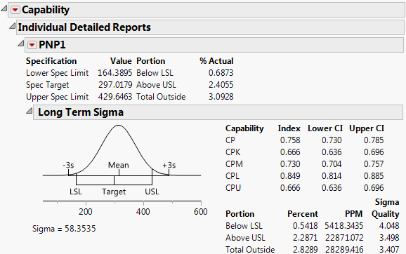

The Individual Detail Reports option displays a capability report for each variable in the analysis. This report is identical to the Capability Analysis Report from the Distribution platform, detailed in Description of the Capability Analysis Report in the Basic Analysis book. Individual Detail Report shows the Individual Detail Report for PNP1 from the Semiconductor Capability.jmp sample data table.
