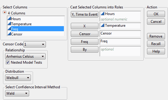

Leave the Censor Code as 1.
7.
8.
9.
Select Weibull as the distribution.
10.
Keep Wald as the confidence interval method.
Fit Life by X Launch Window shows the completed launch window.

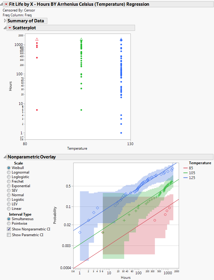

Fit Life by X Report Window for Capacitor ALT.jmp Data shows the top half of the Fit Life by X report window.
