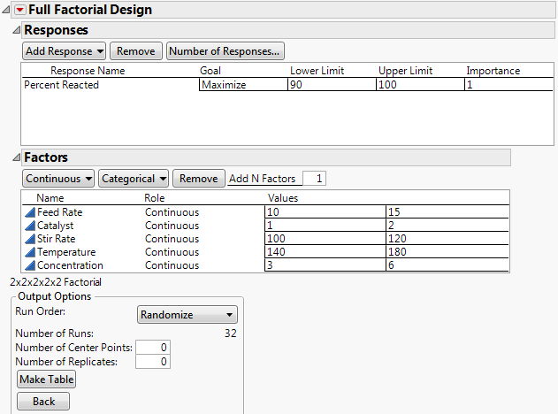

Select DOE > Classical > Full Factorial Design.
Click the Full Factorial Design red triangle and select Load Responses.
5.
Click the Full Factorial Design red triangle and select Load Factors.
6.
Click Continue.
Note: Setting the Random Seed in step 7 ensures that the runs in your design table appear in the same order as in this example. In constructing a design on your own, this step is not necessary.
7.
(Optional) Click the Full Factorial Design red triangle menu and select Set Random Seed. Type 12345 and click OK.

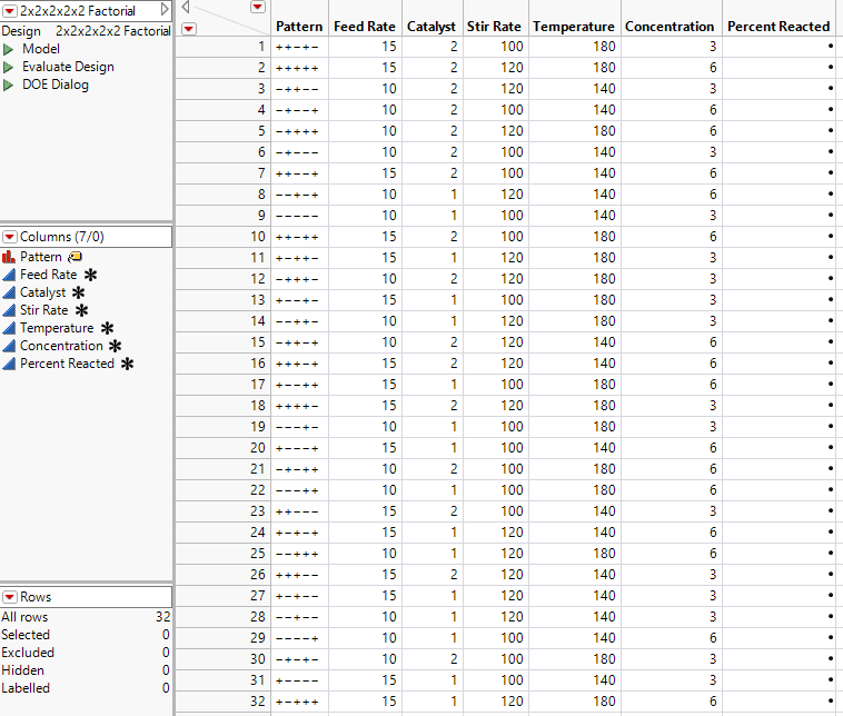

Click Make Table.
The first column in the design data table shows the factor level combination for each run in terms of + and - signs, indicating high and low factor settings. The table also has an empty Y column named Percent Reacted for entering response values as you conduct the experiment.
