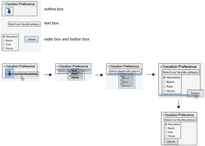

Examples of Dragging Objects into a Container shows the various methods for dragging objects inside a container.

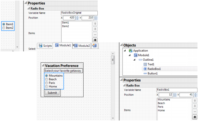

To create the radio box list items in Radio Box Object Properties, double-click the placeholder items “Item1” and “Item2” and enter the new list item.

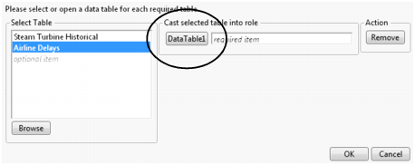

Specifies the absolute or relative filepath for the data table used in the application. You can precede the data table name with a path variable (such as $HOME or $USER_APPDATA).
Specifies the string used when prompting the user to open a data table. Label in Data Table Prompt Window shows the default value.

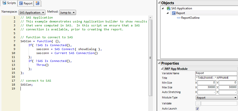

To see the scripts in these namespaces, click the Scripts tab and then select the namespace in the Namespace list (or in the Objects pane). See Application and Module Namespaces.

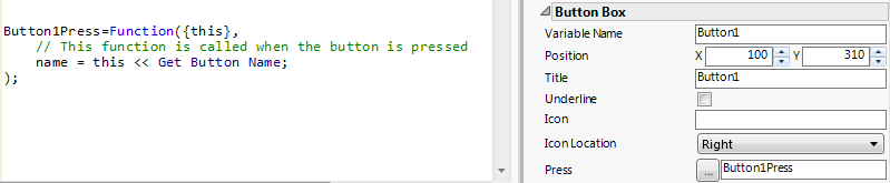

A named script is a function that several controls can use. The this argument tells which control is calling the function. In the following example, Get Button Name is sent to the this argument to print the button name to the log when the button is clicked:
Button1Press = Function({this}, Print(this <<Get Button Name))
On another button, use Button1Press script to produce the same results.
Right-click the object, select Scripts, and then select the script that you want to add. In this example of creating a button, select the Press script. (On Macintosh, press OPTION, and then select Scripts > Press.)
The object’s placeholder script appears on the Scripts tab (New Script and Script Properties). The name of the named script, Button1Press, shows up in both the script and the object properties.
