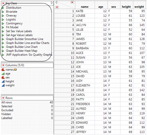

To automatically complete various analyses and tasks, you can create a JSL script and save it to the data table. See Scripts Saved With the Data Table. For details about writing data table scripts, see Table Scripts in the Scripting Guide.
From the report window, click on the red triangle menu for the platform and select Save Script > To Data Table.

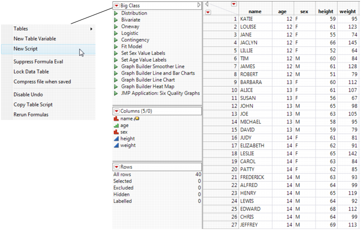

Tip: If you want a particular script to run automatically every time the data table is opened, name the script OnOpen. Only one script saved in the data table can be set to run automatically. If you name the script Model (or model) in a Fit Model script, the launch window is automatically filled in based on the script when you select Analyze > Fit Model.
Select New Script.
