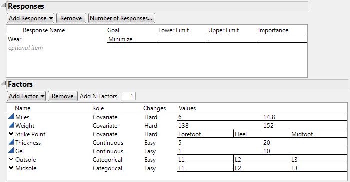

Select DOE > Custom Design.
Double-click Y under Response Name and type Wear.
Click Maximize under Goal and change it to Minimize.
Click Add Factor and select Covariate.
Select Miles, Weight, and Strike Point from the list and click OK.
For one of the factors Miles, Weight, and Strike Point, under Changes, click Easy and change it to Hard.
To add the remaining factors manually, follow step 8 through step 16. Or, to load factors from a saved table, select Load Factors from the red triangle menu next to Custom Design. Open the Runners Factors.jmp sample data table, located in the Design Experiment folder. If you select Load Factors, skip step 8 through step 16.
Type 2 next to Add N Factors.
10.
Rename the two factors Thickness and Gel.
11.
Change the Values for Thickness to 5 and 20.
12.
Change the Values for Gel to 1 and 10.
13.
14.
Click Add Factor > Categorical > 3 Level.
15.
Rename the two factors Outsole and Midsole.
Keep the default Values for these factors.

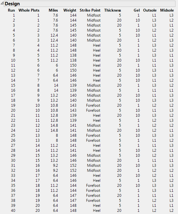

First 40 Runs of Design for Hard-to-Change Covariates
Of the 100 runners, 32 are selected based on their covariate values. The rows corresponding to the selected runners are selected in the RunnersCovariates.jmp sample data table. Settings of the experimental factors Thickness, Gel, Insole, and Outsole are determined so that the design is optimal for the model described in the Model Outline.

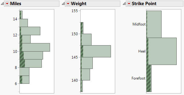

Histograms for 100 Runners with Selected Runner Data Shaded
The histograms indicate that all of the runners with Miles of 14.0 or higher were selected. Runners at the extremes of the Weight distribution were selected. Almost all of the runners with a Strike Point of Forefoot were selected. Notice that the design is somewhat balanced in terms of Strike Point.
