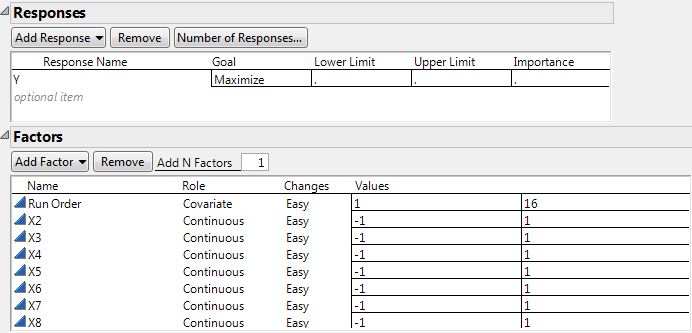

Click Add Factor > Covariate.
9.
Select Run Order and click OK.
10.
Type 7 next to Add N Factors.
11.
Click Add Factor > Continuous.
Responses and Factors Outlines
12.
Click Continue.

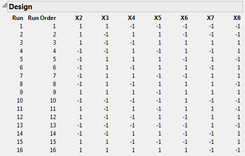

Click Make Design.
Design Outline
18.

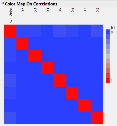

Open the Design Evaluation > Color Map On Correlations outline.
Color Map Showing Absolute Correlations with Run Order
The seven continuous factors, X2 through X8, are orthogonal to each other.
Run Order, the linear time trend variable, has extremely low absolute correlation with X2 through X8.

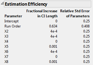

Open the Design Evaluation > Estimation Efficiency outline.
Estimation Efficiency Outline
The small absolute correlations of Run Order with X2 through X8 result in very small increases in confidence interval lengths, relative to an ideal orthogonal design. The increases in the lengths of confidence intervals for X2 through X8 are all less than 0.1%.
