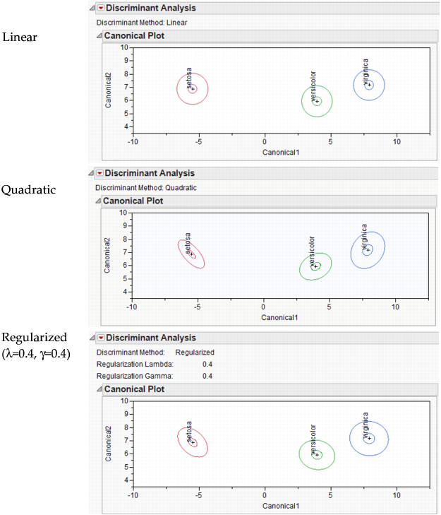

The Linear, Quadratic, and Regularized methods are illustrated in Linear, Quadratic, and Regularized Discriminant Analysis. The methods are described here briefly. For technical details, see Saved Formulas.
Performs linear discriminant analysis. This method assumes that the within-group covariance matrices are equal. SeeLinear Discriminant Method.
Performs quadratic discriminant analysis. This method assumes that the within-group covariance matrices differ. This method requires estimating more parameters than the Linear method requires. If group sample sizes are small, you risk obtaining unstable estimates. See Quadratic Discriminant Method.
Provides two ways to impose stability on estimates when the within-group covariance matrices differ. This is a useful option when group sample sizes are small. See Regularized, Compromise Method and Regularized Discriminant Method.

The first parameter (Lambda, Shrinkage to Common Covariance) specifies how to mix the individual and group covariance matrices. For this parameter, 1 corresponds to Linear Discriminant Analysis and 0 corresponds to Quadratic Discriminant Analysis.
The second parameter (Gamma, Shrinkage to Diagonal) is a multiplier that specifies how much deflation to apply to the non-diagonal elements (the covariances across variables). If you choose 1, then the covariance matrix is forced to be diagonal.
Assigning 0 to each of these two parameters is identical to requesting quadratic discriminant analysis. Similarly, assigning 1 to Lambda and 0 to Gamma requests linear discriminant analysis. Use Regularized Discriminant Analysis to help you decide on the regularization. See Linear, Quadratic, and Regularized Discriminant Analysis for examples of linear, quadratic, and regularized discriminant analysis.
