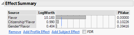

The Effect Summary report appears if your model contains more than one effect. It lists the effects estimated by the model and gives a plot of the LogWorth (or FDR LogWorth) values for these effects. The report also provides controls that enable you to add or remove effects from the model. The model fit report updates automatically based on the changes made in the Effects Summary report. For details, see Effect Summary Report in the Standard Least Squares Report and Options chapter in the Fitting Linear Models book.
Effect Summary Report shows the Effect Summary report obtained by running the script MaxDiff for Flavor in Potato Chip Responses.jmp.
