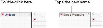

Select File > New > Data Table to create an empty data table.
Note: To rename a column, you can also double-click the column name or select the column and press Enter.

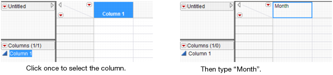

6.

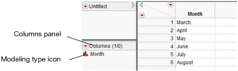

Enter the Month information by clicking in a cell and typing.
Month Column Completed
In the columns panel, look at the modeling type icon to the left of the column name. It has changed to reflect that Month is now nominal (previously it was continuous). Compare the modeling type shown for Column 1 in Entering a Column Name and for Month in Month Column Completed. This difference is important and is discussed in View or Change Column Information.
