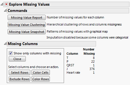

Select Analyze > Screening > Explore Missing Values.
Select all columns (280 in all) and click Y, Columns.
The Missing Columns report shown in Missing Value Report indicates that only five columns have missing data. Out of a total of 452 rows, Column J has 376 missing values. Because it is largely missing, it is not useful for data analysis, even with imputed values. However, it might be useful to model Column J using the Informative Missing option in a platform that supports this option to see if values are perhaps not missing at random.
