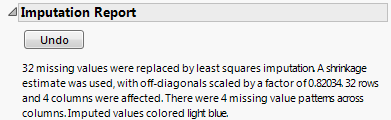

A JMP Alert appears, informing you that you should use the Save As command to preserve your original data.
9.
Click OK.
The Imputation Report in Imputation Report indicates how many missing values were imputed and the specific imputation details. No missing data remain in the four columns that had missing values.
