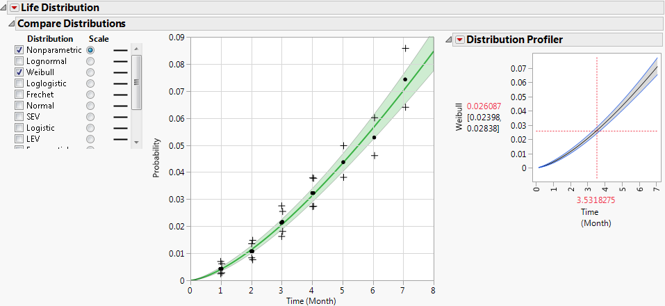

Click the Life Distribution disclosure icon.
JMP fits production and failure data to a Weibull distribution using the Life Distribution platform. (Life Distribution Report). JMP then uses the fitted Weibull distribution to forecast returns for the next five months (Forecast Report).

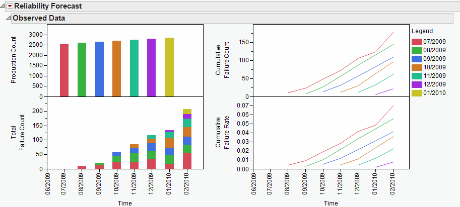

The Forecast report shows previous production on the left graph (Forecast Report). On the right graph, you see that the number of previous failures increased steadily over time.

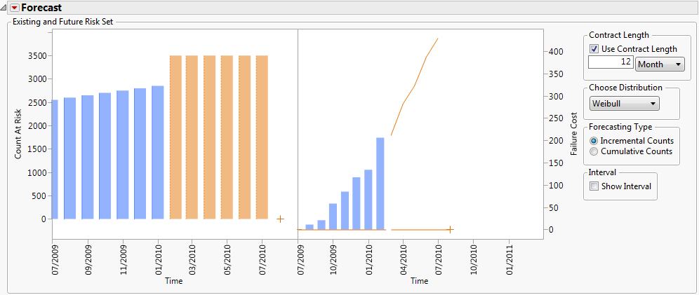

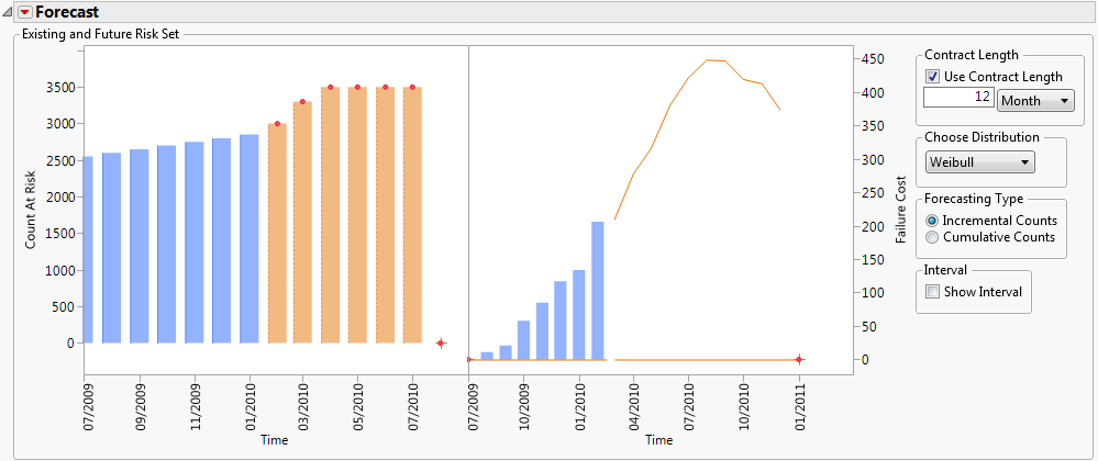

Orange bars appear on the left graph to represent future production. The monthly returned failures in the right graph increase gradually through August 2010 (Production and Failure Estimates).
