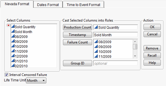

Launch the Reliability Forecast platform by selecting Analyze > Reliability and Survival > Reliability Forecast.

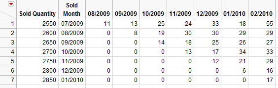

Contract data is commonly stored in the Nevada format: shipment or production dates and failure counts within specified periods are shaped like the state of Nevada. Example of the Nevada Format shows the Small Production.jmp sample data table.

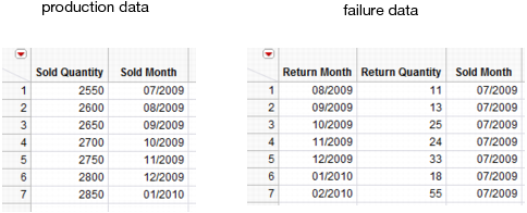

Example of the Dates Format shows the Small Production part1.jmp and Small Production part2.jmp sample data tables.
