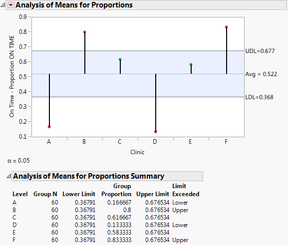

This example uses the Office Visits.jmp sample data table, which records late and on-time appointments for six clinics in a geographic region. 60 random appointments were selected from 1 week of records for each of the six clinics. To be considered on-time, the patient must be taken to an exam room within five minutes of their scheduled appointment time. Examine the proportion of patients that arrived on-time to their appointment.

From the red triangle menu next to Contingency Analysis, select Analysis of Means for Proportions.
8.
From the red triangle menu next to Analysis of Means for Proportions, select Show Summary Report and Switch Response Level for Proportion.
Example of Analysis of Means for Proportions shows the proportion of patients who were on-time from each clinic. From Example of Analysis of Means for Proportions, notice the following:
