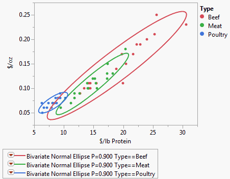

From the red triangle menu, select Density Ellipse > 0.90.
To color the points according to Type, proceed as follows:
10.
Right-click on the scatterplot and select Row Legend.
11.
The ellipses in Example of Group By show clearly how the different types of hot dogs cluster with respect to the cost variables.
