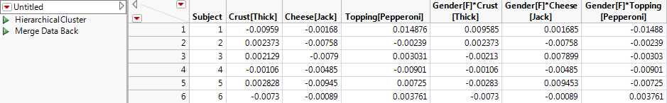

Click the green triangle next to the Hierarchical Cluster script.
The script runs a hierarchical cluster analysis on all columns in the gradient table, except for Subject. Click on either diamond to see that the rows have been placed into three clusters.
5.
A new column called Cluster is added to the data table containing the gradients. Each subject has been assigned a Cluster value that is associated with other subjects having similar gradient forces. See Hierarchical Cluster in the Multivariate Methods book for a discussion of other Hierarchical Clustering options.
