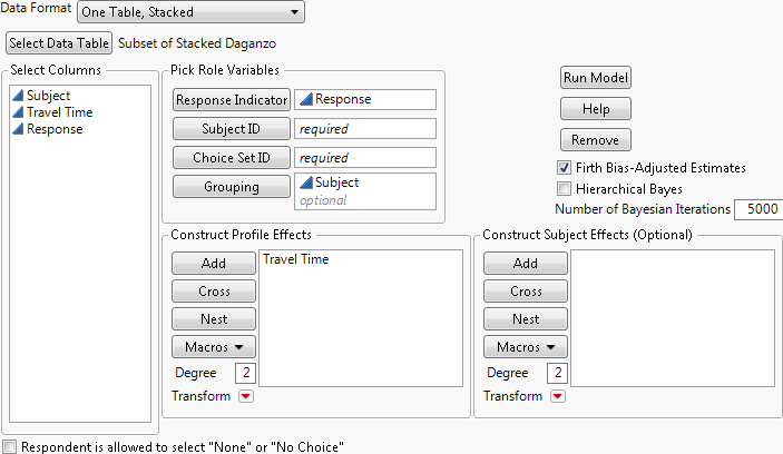

Select Analyze > Consumer Research > Choice to open the launch window and specify the model as shown in Choice Dialog Box for Subset of Stacked Daganzo Data for One-Table Analysis.

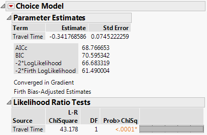

Click Run Model.
