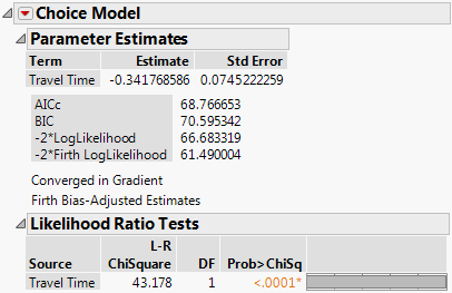

Now that you have separated the original Daganzo Trip.jmp table into two separate tables, you can run the Choice Platform.
Select Analyze > Consumer Research > Choice.
From the Data Format list, select Multiple Tables, Cross-Referenced.
Choice Dialog Box for Subset of Daganzo Data
Click Run Model.
Parameter Estimate for Travel Time of Daganzo Data
