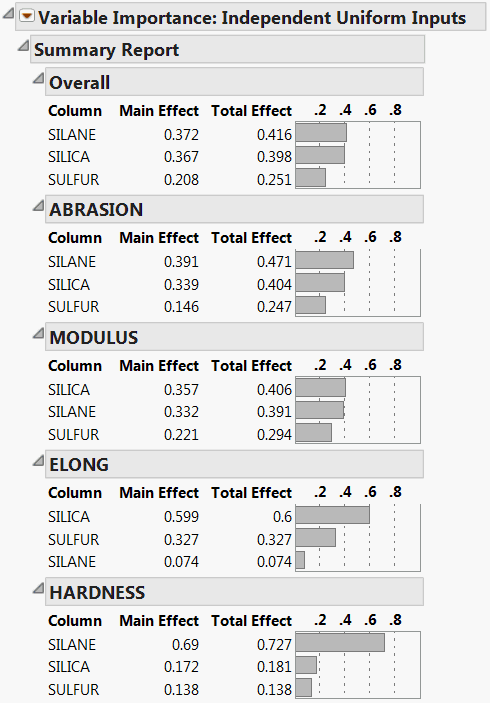

The data in the Tiretread.jmp sample data table are the result of a designed experiment where the factors are orthogonal. For this reason, you use importance estimates based on independent inputs. Suppose that you believe that, in practice, factor values vary throughout the design space, rather than assume only the settings defined in the experiment. Then you should choose Independent Uniform Inputs as the sampling scheme for your importance indices.
Run the script RSM for 4 Responses.
From the red triangle menu next to Prediction Profiler, select Assess Variable Importance > Independent Uniform Inputs.
The Summary Report is shown in Summary Report for Four Responses. Because the importance indices are based on random sampling, your estimates might differ slightly from those shown in the figure.

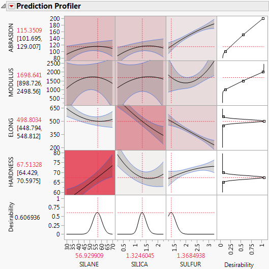

The report shows tables for each of the four responses. The Overall table averages the factor importance indices across responses. The factors in the Profiler (Profiler for Four Responses) have been reordered to match their ordering on the Overall table’s Total Effect importance.
Colors from a red to white intensity scale are overlaid on profiler panels to reflect Total Effect importance. For example, you easily see that the most important effect is that of Silane on Hardness.

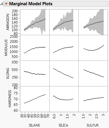

The Marginal Model Plots report (Marginal Model Plots for Four Responses) shows mean responses for each factor across a uniform distribution of settings for the other two factors.
