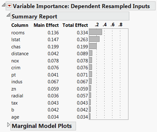

From the red triangle menu next to Prediction Profiler, select Assess Variable Importance > Dependent Resampled Inputs.
The Variable Importance: Dependent Resampled Inputs report appears (Dependent Resampled Inputs Report). Check that the Prediction Profiler cells have been reordered by the magnitude of the Total Effect indices in the report. In Dependent Resampled Inputs Report, check that the Total Effect importance indices identify rooms and lstat as the factors that have most impact on the predicted response.

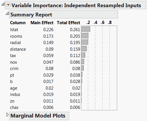

10.
From the red triangle menu next to Prediction Profiler, select Assess Variable Importance > Independent Resampled Inputs.
The resampled inputs option makes sense in this example, because the distributions involved are not uniform. The Variable Importance: Independent Resampled Inputs report is shown in Independent Resampled Inputs Report. Check that the two factors identified as having the most impact on the predicted values are lstat and rooms. Note that the ordering of their importance indices is reversed from the ordering using Dependent Resampled Inputs.
