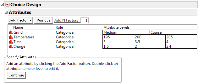

You can enter factors either manually or automatically using a preexisting table that contains the factors and settings. In this example, for convenience, you use a preexisting table. But, if you are designing a new experiment, you must first enter the factors manually. For details on entering factors manually, see Attributes.
Click the Choice Design red triangle and select Load Factors.
Click Continue.
