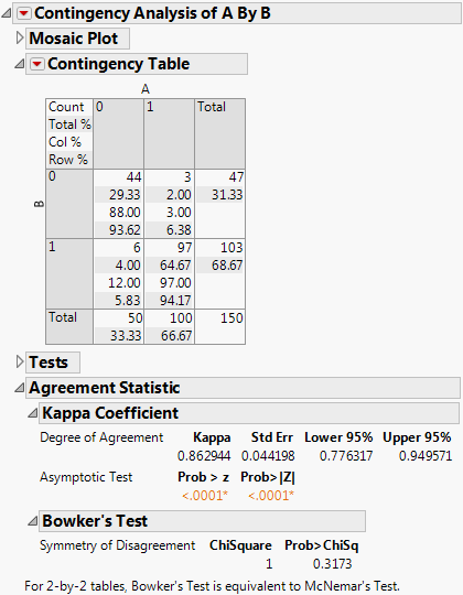

This example uses the Attribute Gauge.jmp sample data table. The data gives results from three people (raters) rating fifty parts three times each. Examine the relationship between raters A and B.
Select Analyze > Fit Y by X.
5.
Click OK.
6.
From the red triangle menu next to Contingency Analysis, select Agreement Statistic.
From Example of the Agreement Statistic Report, you notice that the agreement statistic of 0.86 is high (close to 1) and the p-value of <.0001 is small. This reinforces the high agreement seen by looking at the diagonal of the contingency table. Agreement between the raters occurs when both raters give a rating of 0 or both give a rating of 1.
