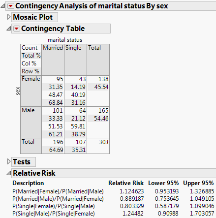

This example uses the Car Poll.jmp sample data table. Examine the relative probabilities of being married and single for the participants in the poll.
Select Analyze > Fit Y by X.
5.
Click OK.
6.

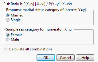

If you are interested in only a single response and factor combination, you can select that here. For example, if you clicked OK in the window in The Choose Relative Risk Categories Window, the calculation would be as follows:
If you would like to calculate the risk ratios for all (
=4) combinations of response and factor levels, select the Calculate All Combinations check box. See Example of the Risk Ratio Report. |
7.
Ask for all combinations by selecting the Calculate All Combinations check box. Leave all other default selections as is.
= 1.1247
