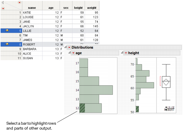

Click on a histogram bar or an outlying point in the graph. The corresponding rows are highlighted in the data table, and corresponding sections of other histograms are also highlighted, if applicable. See Highlight Bars and Select Rows.

Clicking on a histogram bar highlights the bar and selects the corresponding rows in the data table. The appropriate portions of all other graphical displays also highlight the selection. Highlighting Bars and Rows shows the results of highlighting a bar in the height histogram. The corresponding rows are selected in the data table.
