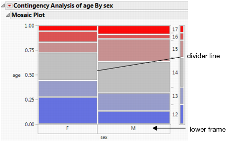

To extend the divider line to the x-axis labels, follow these steps:
Select Tick Marks > Divider Lines to add the lines, or Lower Frame to add a frame around the axis area.
