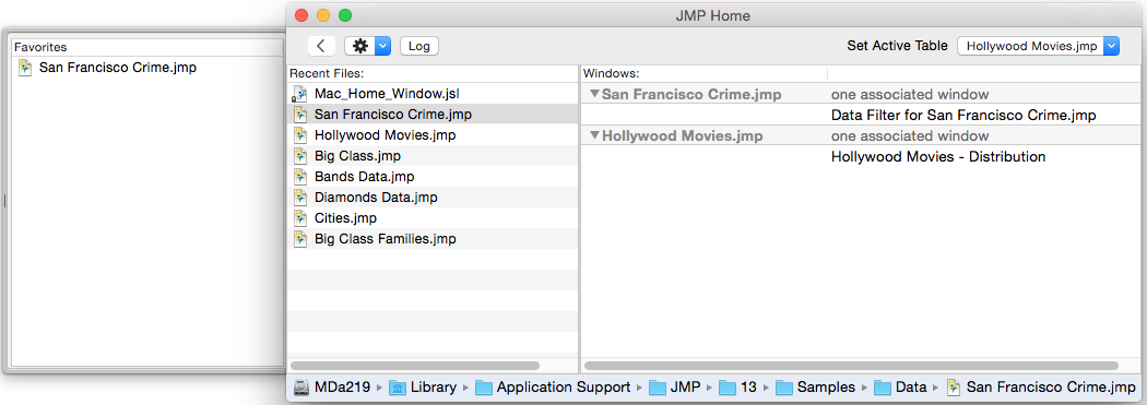

Open the JMP Home window on Macintosh by selecting Window > JMP Home (Example of the JMP Home Window (Macintosh)). To view the window each time you open JMP, select JMP > Preferences > General > Home Window.
