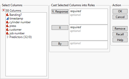

In the launch window, select the analysis columns as Y, Columns. You can also specify a By variable. After you click OK, the Explore Outliers report appears. You are presented with the following four outlier analysis commands:

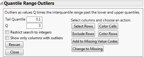

The Quantile Range Outliers panel enables you to specify how outliers are to be calculated and how you want to manage them. Quantile Range Outliers Window shows the default Quantile Range Outliers window.
An outlier is considered any value more than Q times the interquantile range from the lower and upper quantiles. You can adjust the value of Q and the size of the interquantile range.
The multiplier that helps determine values as outliers. Outliers are considered Q times the interquantile range past the Tail Quantile and
values. Large values of Q provide a more conservative set of outliers than small values. The default is 3.
values. Large values of Q provide a more conservative set of outliers than small values. The default is 3.Turns on the exclude row state for the selected rows. Click Rescan to update the Quantile Range Outliers report.

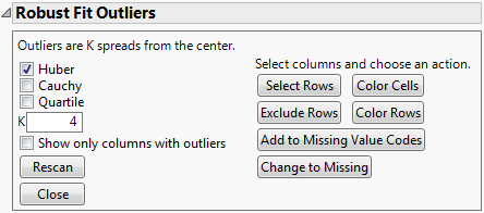

Robust estimates of parameters are less sensitive to outliers than non-robust estimates. Robust Fit Outliers provides several types of robust estimates of the center and spread of your data to determine those values that can be considered extreme. Robust Fit Outliers Window shows the default Robust Fit Outliers window.
Given a robust estimate of the center and spread, outliers are defined as those values that are K times the robust spread from the robust center. The Robust Fit Outliers window provides several options for calculating the robust estimates and multiplier K as well as provides tools to manage the outliers found.
The multiplier that determines outliers as K times the spread away from the center. Large values of K provide a more conservative set of outliers than small values. The default is 4.

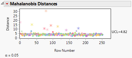

Multivariate Robust Outliers Mahalanobis Distance Plot shows the Mahalanobis distances of 16 different columns. The plot contains an upper control limit (UCL) of 4.82.This UCL is meant to be a helpful guide to show where potential outliers might be. However, you should use your own discretion to determine which values are outliers. For more details about this upper control limit (UCL), see Mason and Young (2002).
